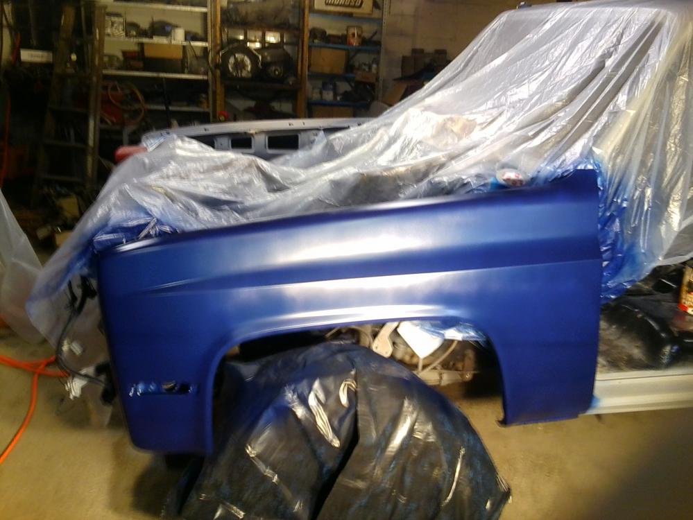

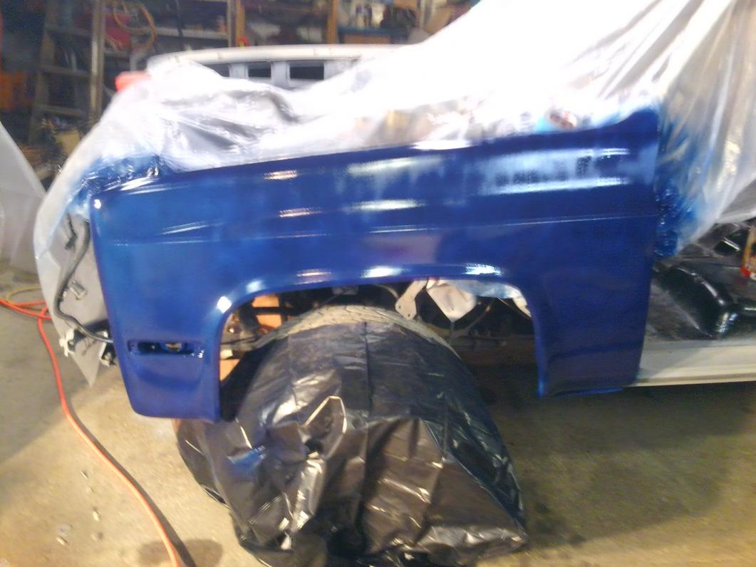

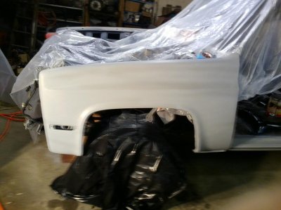

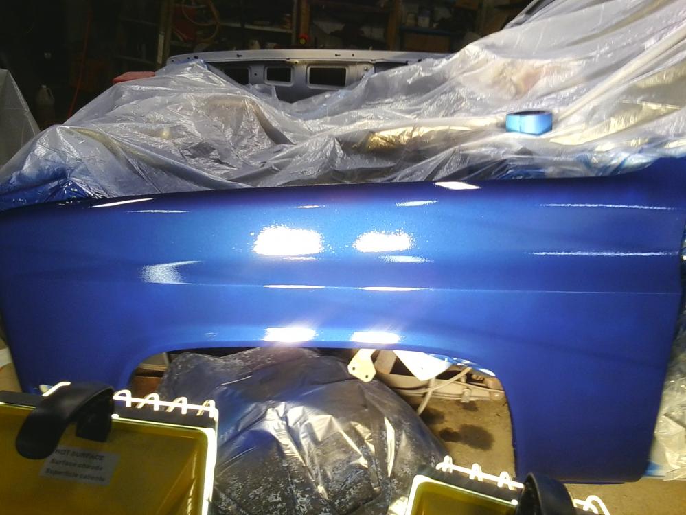

hey guys heres a pic of my fender i painted, sherwin willaims have me a great price on a pint of base and clear to test it out i guess im starting to paint my k20 now. I choose a dark blue, and it is dark but with the lights it looks lighter.
I practiced on an old hood and got the feel of the gun. i love useing a gun. when i layed the first coat of base i was like AHH tiger stripes but with the 2nd coat and drying they went away. I just got 2 light spots i gota scuff up and do again.
i think it tured out really good for my first time with a gun, now i just gota fix the orange peel issue. advice????

wetsand and buff.
it's hard to avoid ALL orange peel and such unless you got a both, completely dirt free, very experiences, gun setup perfect and perfect paint mix etc.
I spray em, sand em, and buff em.
looks alot like my blue, it's darker tho, maybe it's your lights and mine will be lighter too in the lights, I aint sure. I haven't painted anything with it yet just saw the color chip.

to avoid orange peel in clear coat you have to spray it wet at a higher pressure with the gun close to the body and move pretty quick across it.
almost to the point of the paint running it is a experiance thing. you run alot until you figure it out. the wetter the paint the more time it has to lay out smooth its self out before it dries. and do not have the room to hot or the paint will dry to fast. and to cold it takes forever to dry. and i like to use the slower reducers to give more time for it to lay out. just takes longer to dry.
maybe just try spaying it a little more wet no dry spots while spraying
i rarely buff anything i paint now after a couple years painting in shops i became a pretty good painter and i still do side jobs for people

thanks for the advice. im happy with how it turned out for my first time. when i layed the first coat i saw striping and got scared that i screwed up but as soon as it dried it went away.

I applaud you Liam! I think that's pretty friggin good for a first timer. It's nothing some wet sanding a buffing couldn't clear up.
EDIT: LOVE the color too!
