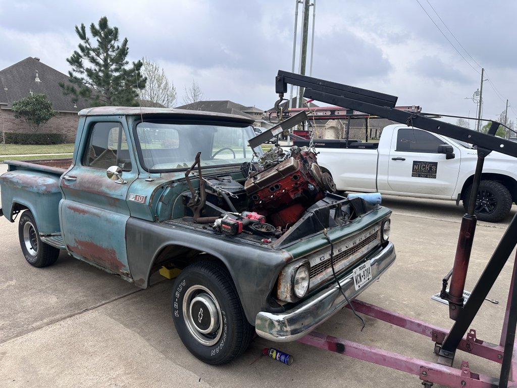

Should be a 14mm; I would think there is a special made tap/thread chaser for that. Do you have a well stocked parts store near you?
Yeah, and I also have a couple hundred piece tap and die set from northern tool so when I get back from lunch, I’ll check that out. Going to Harbor freight right now to get another hydraulic jack from my engine hoist. It quit hoisting and it’s super old, all the O-rings are blown out of it and I’m done with it.

I would get a back tap/chaser from a local auto parts store over using a cut tap to chase the threads. Especially over a cheaper cut tap. A lot of times they [cheap taps] will cut oversized on the major diameter.
I don’t know for certain on sbc head spark plug holes, but a lot of automotive components have a thread form that has a radius instead of a sharp V profile at the major diameter, this removes the potential stress riser and makes a stronger thread. A tap will cut that radius out and make it a sharp vee. Maybe it would make no difference, but I’d go chaser over cut tap.
Once i got the engine out i was able to get it to take a plug
