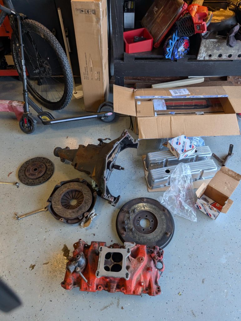

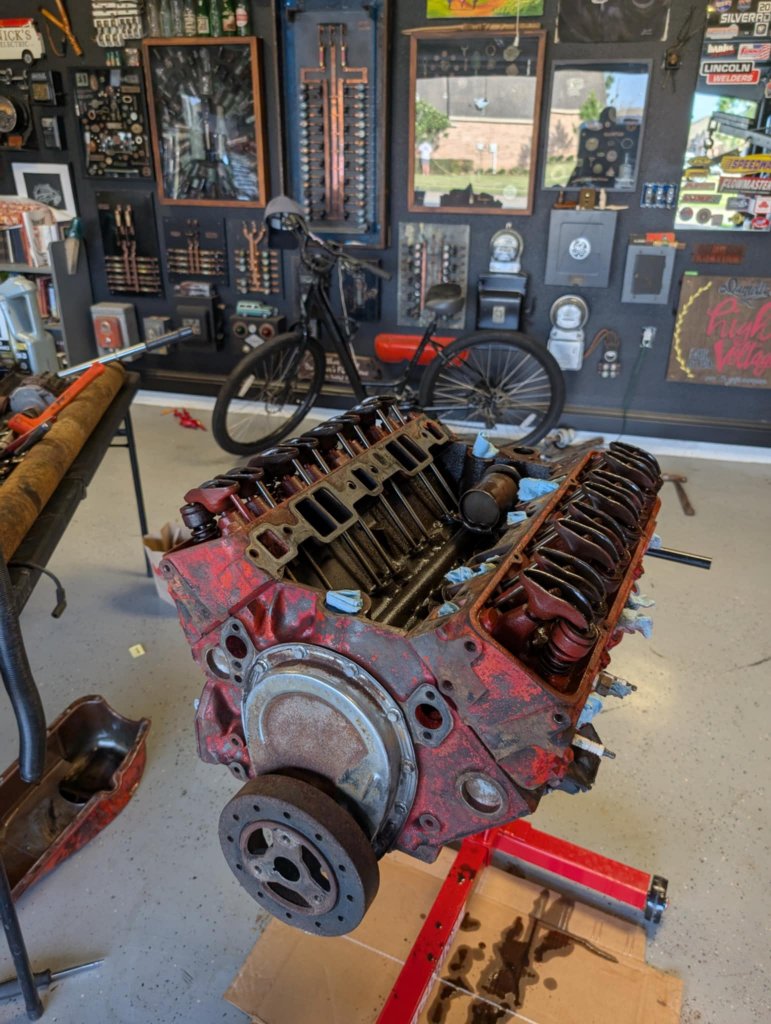

I guess it will make you all happy to know that as of last night I decided to continue the 283 build since i received all the 400 in parts i bought for it.
Today I went to horrible freight and bought an engine stand, got it mounted with hardware store bolts, removed the intake, pan, replaced the crank seal, and oil pump and pickup tube.
I want to do one of those comp thumpr cams. I need to buy a new oil pan, and a newer intake manifold. The massive oil leak was due to them expansion plugging the old 1" hole on the back by the distributor known as the oil tube hole....I'm not doing that this time

With all that said, how do we determine if this is the original engine? I dont have any codes in the glove box, the engine number is 3789817. Its been completely gone through andn honestly doesnt look bad at all

There should be a flat pad with numbers and letters stamped here (if it's not been decked before), then you can look that up and should provide more information on what it originally was in/power rating/etc

guess its bored 60 the pistons are marked 060

I'm getting old,
T I I 2 7 D K
Looks like DK is '63 or older, with 2bbl and automatic. There should be a date code on the block, if you want to narrow it down. What is the head casting #? They are later heads, with accessory holes.
Any cross hatching still visible in the cylinders?
