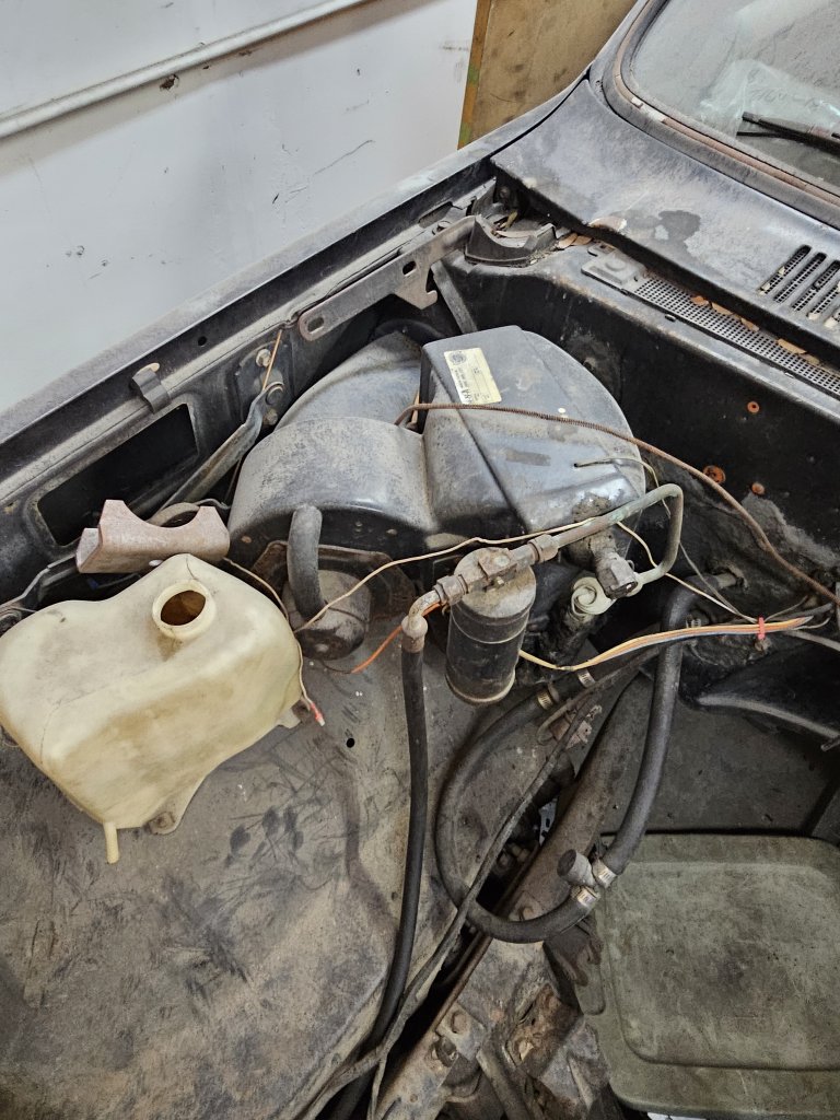

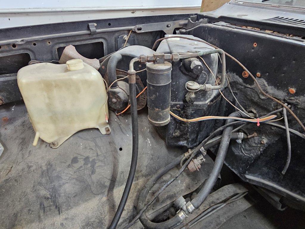

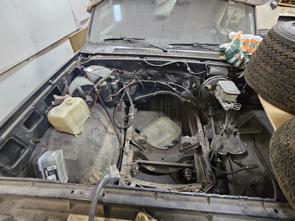

So a little background info on the truck:
Although from the factory it was a non-a/c truck, someone before us did add an aftermarket a/c kit, which looks to be something like you'd order out of a JC Whitney catalog back in the day. I haven't driven the truck in probably 12+ years (we traded it away, I bought it back a few years later after spotting it in someone's yard while driving through town, then it sat for several years in my possession, and now I'm able to get it back on the road), but I do remember the a/c didn't quite keep up that well. It worked, and it was better than nothing, but it wasn't great. My hope was to find all of the factory components and install them, and run them off the LS compressor as part of the swap.
I don't really want to spend the money that the VA system would cost, and if I can't find the complete factory a/c setup and make that work I'll try and get the aftermarket kit on there working and just use that. Although I'm not sure where to even get replacement parts at this point, and like I mentioned, the truck has been off the road for a bunch of years at this point. My hesitation was spending the money on custom lines and all that to attach to the aftermarket kit on there now, and finding out it either no longer works, or just works pretty poorly.
To further complicate things, I'm trying to have the truck done, driving, and roadtrip-worthy to take the it on Power Tour in June, which is already a lofty goal with my schedule and time available. Pictures attached of the current aftermarket a/c kit on the truck.

I tend to agree with it being an aftermarket unit, not one I am familiar with.. My guess is it now obsolete and quite possibly parts are no longer available.. Those Vintage Air units have gone up in price drastically in the past year.. Post covid, they were approximately $1400- $1500.. Today they are over $2,000... Here's the thing about going with original factory pieces.. You won't have a big problem locating parts.. One or 2 donor trucks and you'll probably have everything you'll need.. Here's the drawback.. You cannot (re)use the accumulator/drier, a new one is required.. Same thing goes for the hoses.. It would be extremely risky to (re)use an "elderly" evaporator. They are prone to leak with age.. I can't count the number of 3 - 4 year old evaporators I've replaced. The condenser is also prone to leak with age.. You will save some money -----but for the most part ---- you'll have a 40 something year old AC unit...
So more than anything I need the housings, and the diverter blades and all of the miscellaneous parts and pieces that go with them, as well as the control unit and any associated wiring. Most of the "guts" and wearable parts I would be replacing with new, and for a little over $200 on Rockauto (quick examples selected below, not exact) I can have the bulk of them. The lines would be custom anyway since they'd have to go from the LS compressor to the C10 drier and condenser. I've had success in the past going to a local hydraulic shop with a mockup of what I need in terms of line length and fitting orientation and having them crimp it for me, so that's likely what I'd look to do again. And I have the a/c compressor from the donor, which was a truck I owned and drove and know the a/c worked well on.
If I could have a working factory style a/c for under $500 or so, I would be very happy.
