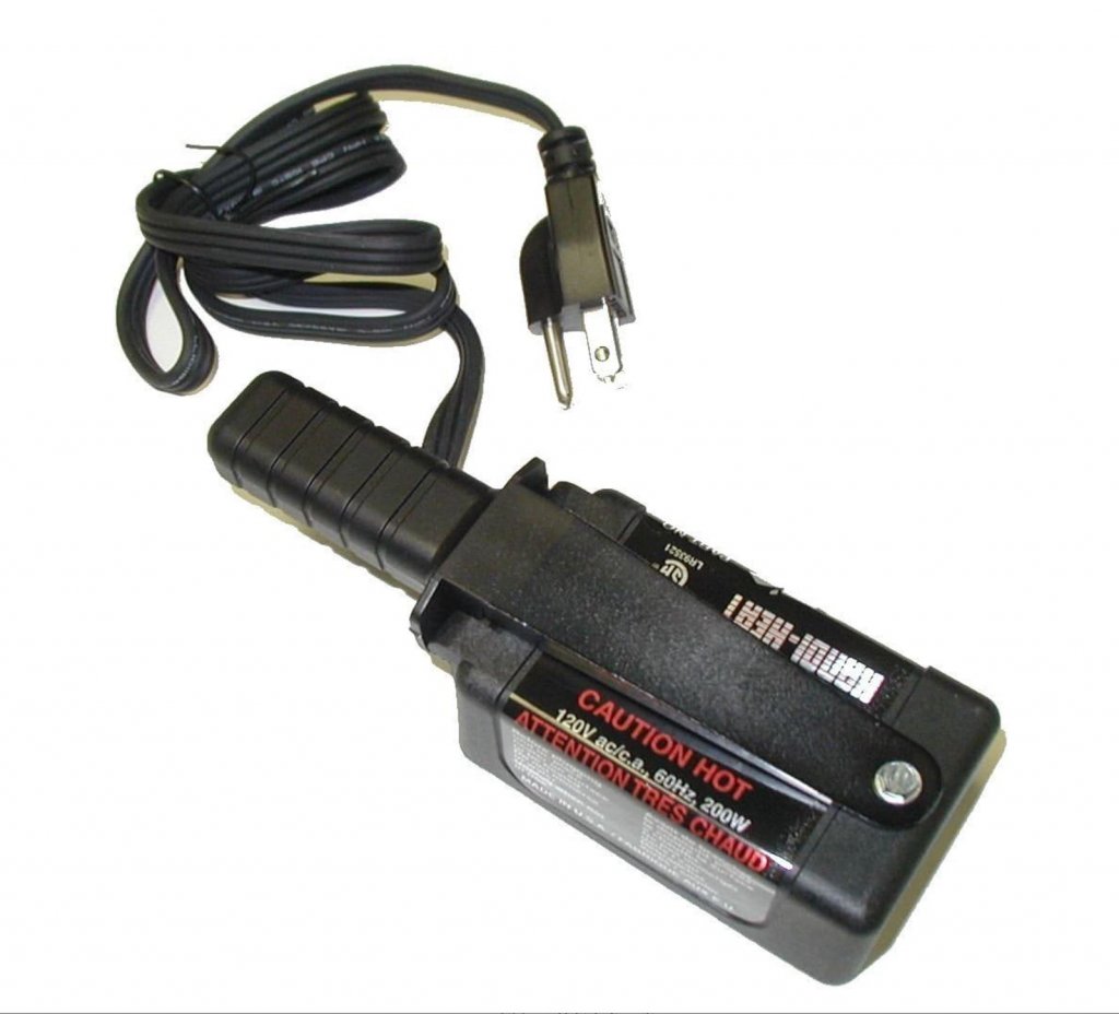

As far as I know, the newer style pads are totally magnetic, high temp silicone. Clean off a spot on your oil pan and stick it, then run your cord and leave it alone, but I have not tried one of those. I the one I had was many years ago was the type pictured below, by Handi-Heat. It worked well, but stuck out a bit and could get knocked off on a rock or something, so I don't know if I would leave it installed like the pad type. They kick ass for tractors and the like, because they are accessible and you can just take it off every day. On a car or truck, not so much.
The freeze plug heater guys have all noted some good experiences, and I suspect that's probably the best overall method long term. But if you don't want to crawl under there and make a mess, then the recirc heater like the Zerostart one Turbo mentioned above is probably a safe bet, and way easier to install. I'm probably going to do that myself.
