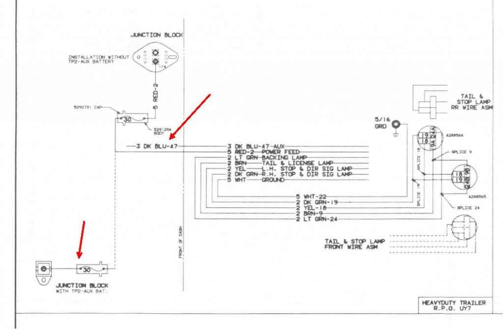

The other wiring that I've kinda got an idea about but am unsure of is these red and blue wires.
They're paired up together starting on the wheel tub and run back towards the trailer hitch. But don't have any plug or label on them, just bundled back there.
Assuming something for a 7 pin harness possibly? (Truck has rpo UY7 - HD 7-LEAD TRAIL. WIRING)

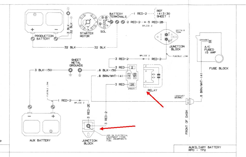

The big relay beside the little junction turns on with the key and off when you switch to cranking.

The red and blue wires are added on by a previous owner.

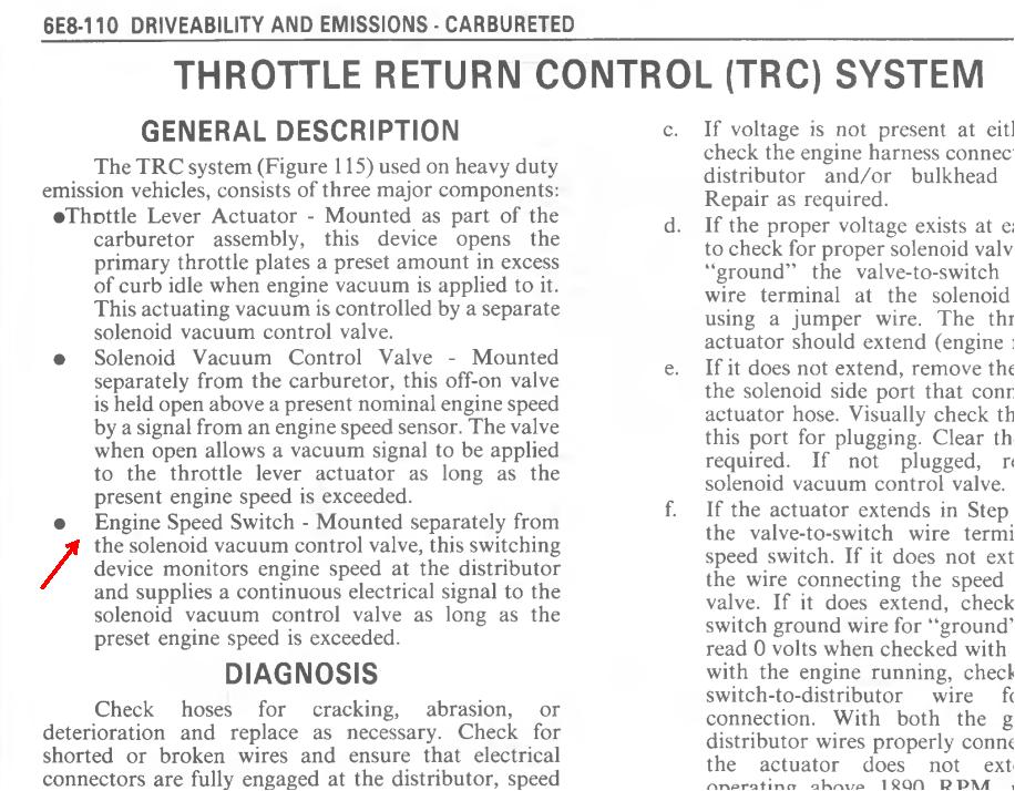

Poking through the wiring diagram I think it is a connector for the Speed SW Relay. I think it has something to do with cruise control but I am not sure.

My ‘75 camper special has a relay in about the same location, and it’s for the camper wiring and 2nd battery. For my truck it is activated by an ignition-on wire from the fuse box, and was designed to provide isolation of the aux battery to power the camper when the engine is not running.. I’m not sure what type of function it would have for the trailering package.

Found same diagram as @edgephoto
Looks like it dealt with the TRC system it once had. Based on looking at diag- The white wire coming from tach off distr is going to speed switch then from switch it signals the valve- That is my guess.. see other attachment-
The 2 pin connector looks like an alternator connector. The other connector I am not sure of. Get us an overview shot of the engine compartments we can see where that connector is located in the harness. Also, if you download the wiring diagram and look for those color wires you might find it that way.
My only opposition to the red and blue being PO added is that it’s got a factory looking tag near the hitch at the rear, naturally, it’s not legible at all.
I’ll see about grabbing a photo today if the rain lets up some.
Im kinda thinking it goes along with @75gmck25 ‘s idea for the second battery this truck used to have, assuming for pull behind camper setup perhaps?
Thank you both @edgephoto and @Jgonick for the identification of these plugs.
Sounds like they’re getting tucked out of the way, as I have none of that equipment and it probably wouldn’t be going back anyway…

My guess is heavy duty trailer & aux battery- i agree with @75gmck25
look at attachments- notice the fuse on red line for trailer and also has a blue wire for aux, (blue wire doesn't look quite correct -but I still think that is what it is)- and the setup for aux battery looks correct. Camper equipped- pretty much the same setup

I wonder if the red and blue wires are a GM accessory?
