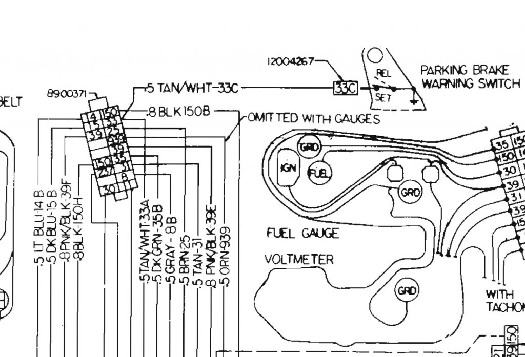

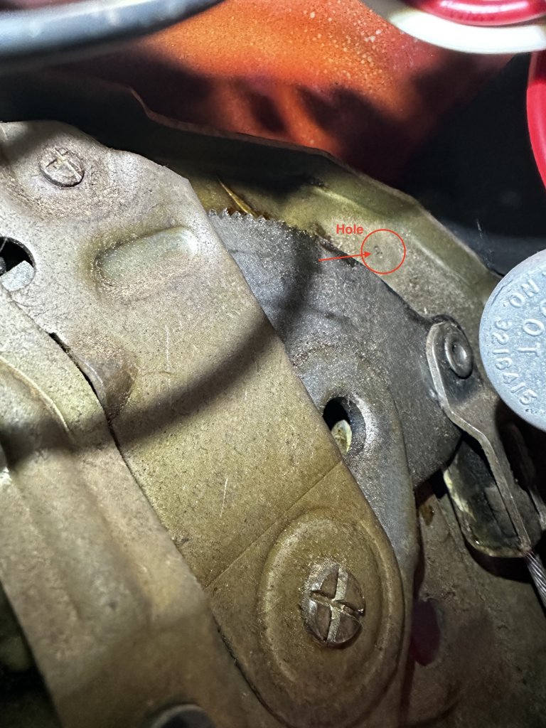

My 79 has a switch on the mechanism, my 76 does not, but the light will come on with the prop valve on the 76
I believe that they appeared in 1979. Wiring diagrams pre-79 do not show the switch, but the 79 does. (See '79 wiring detail) My 76 appears to be drilled for it, but it's not there. (hole location circled, though it appears a bit fuzzy in the pic). Curiously, the 76 service manual assumes that there is a switch and tells you to check the instrument panel brake warning light by applying the parking brake.
