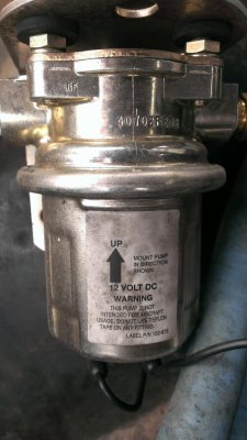

Fuel Pump
That's the fuel just for reference. So what carb do you guys see fit for this engine?

Looks like a general purpose fuel pump from the parts store. Where is it mounted again?
I like Holley carbs, but your current carb may just need some tuning or a refresh.

Fuel Pump
Its mounted in the engine bay on the passenger side fender well. It just feels like it does have much power when its at highway speeds. I've adjusted the carb by turning the screws in all the way and out all the way. Then back half way in. Is that correct? Or what kind of tune are you talking about? Rebuilding the carb?

Pump is mounted too far from the fuel tank. Electric fuel pumps are good at 'pushing' fuel, but not good at 'pulling'.

For sure, it does sound like some dirty circuits in the carb. Gotta keep Eddy's clean and they will work well. Where that fuel pump is now, I'd put an inline filter in.
And for sure, move that pump back under the truck as close to the fuel tank switch valve as possible. Always best to have an E pump as close to the tank as possible.

After you move the pump near the selector switch, test your fuel pressure.
If it's over 4.5 or so, get a regulator. My 1406 flooded something fierce if fuel pressure was over this. Holley's seem to be just fine at 6psi...which is what most e-pumps for carb are rated at.
