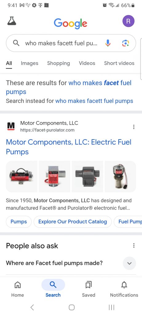

A facett posi flow. American made,ethanol resistant, and great customer service. Well kind of. After you find their phone number they have great customer service. Because faucet isn't the name of the company and I forget what it is. They will direct you to Pegasus racing to buy it. Don't ask them ( Pegasus)questions,anyway the tech guy I got a hold of wasn't as bright as I would have liked. I called back the manufacturer who confirmed what I had called to ask them in the first place and asked who gave me the incorrect info at Pegasus. I said I didn't know,whoever was answering tech questions. Motor components llc is the manufacturer
