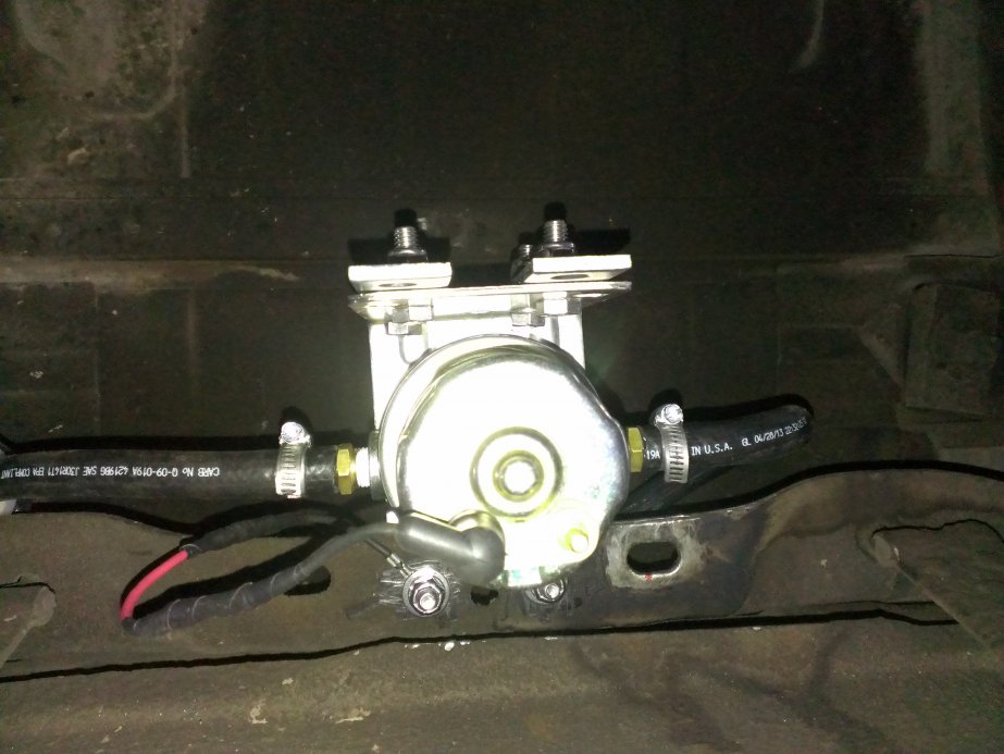

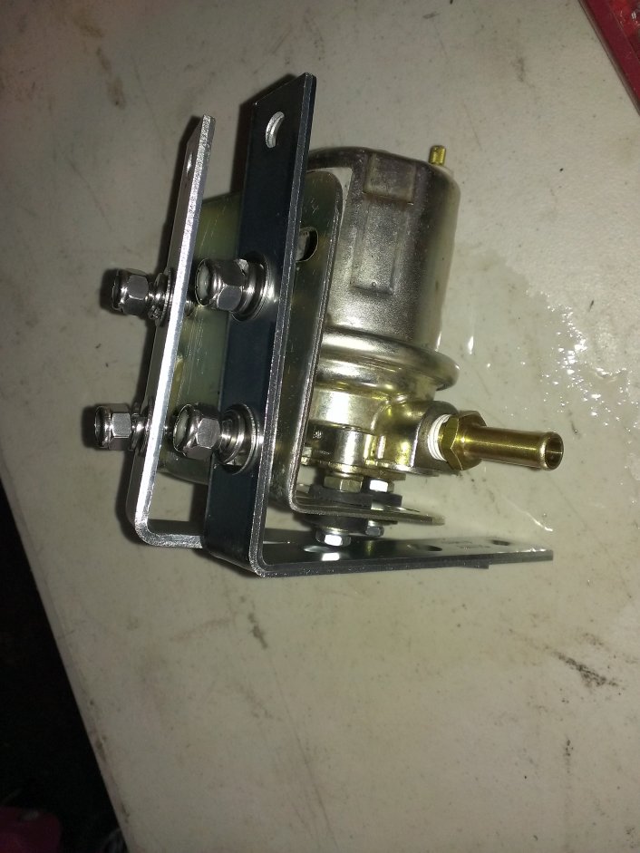

Ok well a month later and I finally made time for my fuel pump relocation. From the engine bay on the fender well to being mounted in front of the tank with a extra fuel filter in between the pump and tank. I kept the filter before the carb in the engine bay. I went to Napa and found out my pump is a carter pump runs 7psi so I didn't go with a regulator. My mounting brackets are two L shape brackets from lowes, mounted to the fuel pump bracket with a couple screws. I cut into the metal lines and added a couple sections of rubber hose. Which i'm going to protect with plastic loom and zip ties. Turned out pretty good, with some help from my father in-law. The blazer runs some much smoother with NO stumble. Ready to take it to the coast for the 4th of July week. Thanks for all the suggestions and help.

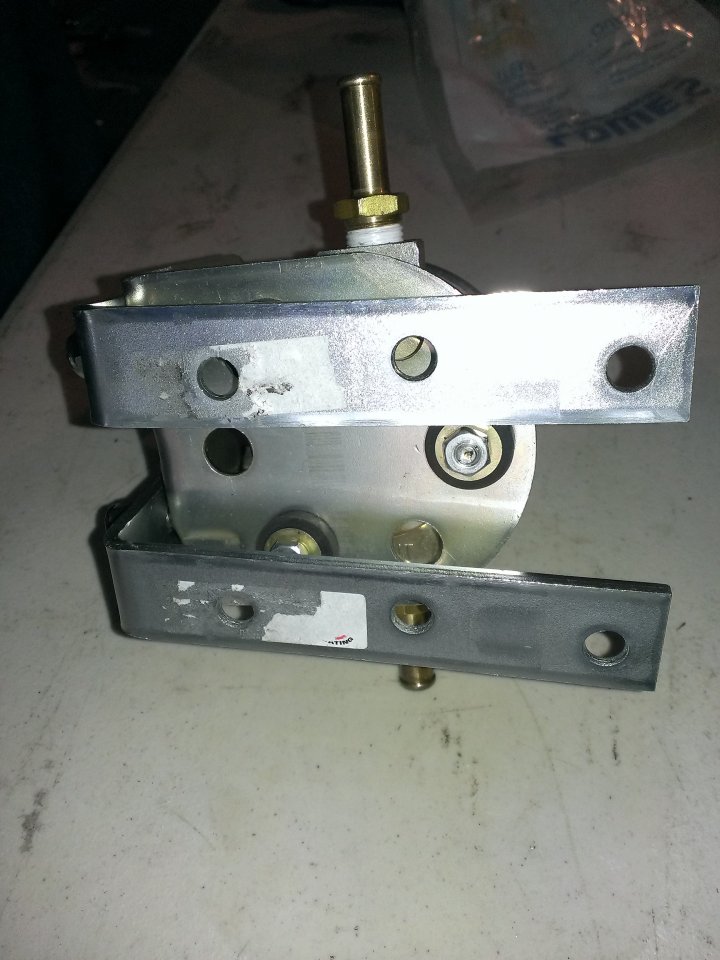

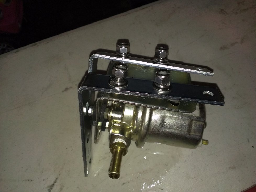

Fuel Pump Relocation
Here are some pictures. These are the brackets mounted to the fuel pump. Comments appreciated..

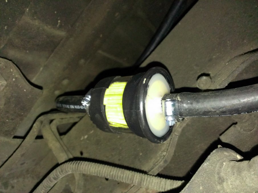

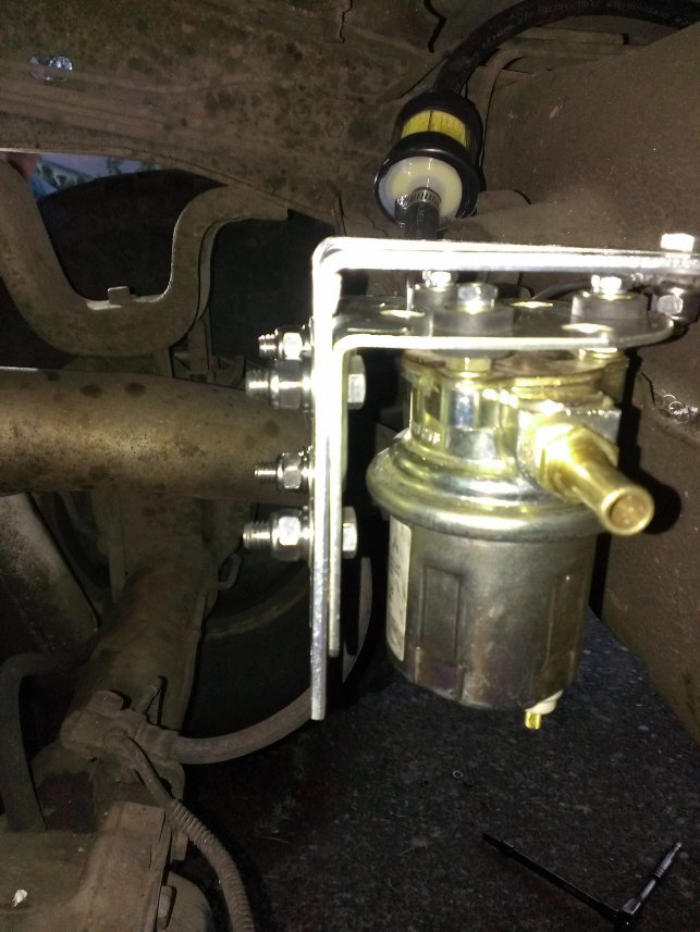

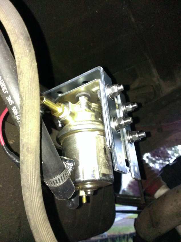

Here are some of the fuel pump mounted onto the front of the fuel tank and the in-line fuel filter..

Should be a nice set up. So are you using a manual pump too or strictly the electric pump?
Both the manual and the electric pump should both be flow thru pumps. I used to use an electric as a back up pump on a toggle switch. Needed it in the summer for vapor lock situations. Also was nice to have when the manual pump quit working. It did even get me home once when the fuel filter got clogged and the electric added just enough umph to push fuel thru the dirty filter.
When the manual pump died, I did leave it on but of course needed electric pump to run from then on. It turned out to be a nice security feature being the truck would run out of fuel if the hidden fuel pump switch was not on. A thief might have gotten it started and maybe a block away but once the float bowl was out of fuel, that was that and the motor ran out of gas.
