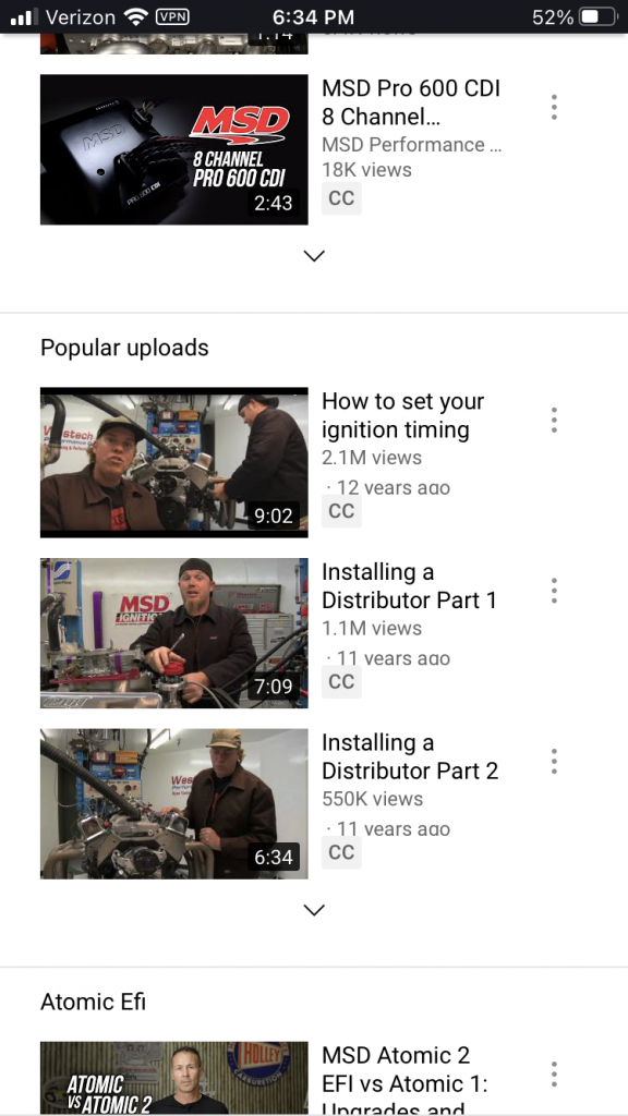

All the info you need is on YouTube.MSD has a very in-depth how to on gm hei distributors.How to find TDC,what to do in your current situation off your oil pump needing to line up.

@Curt more info on that video? I can’t find one, I’ll watch one if I can find one. But tdc on number one the rotor isn’t pointing towards 1. So is that timing chain slipped teeth? Or is it something I’m doing wrong?

MSD channel

I was searching msd gm hei and nothing other that showing the distributors they had to offer came up
