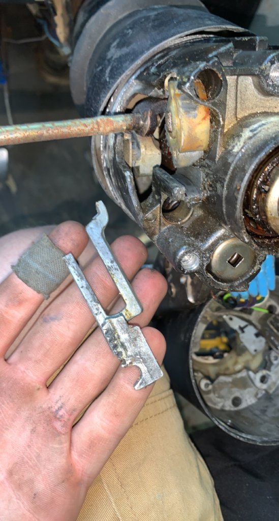

I’d be more than happy to tell you how it drives tomorrow except for the ignition just broke when I tried to go on a test drive… I ended up dropping the column and pulling the rod to get it started back and using vice grips as a “steering wheel” I have the column apart to just after the blinker switch but the tree screws behind it… one is rounded out I tried to drill it to atleast get it apart to get back but that’s one stout bolt or my drill bit is just junk. Is there any way of changing this rod without removing the three screws?
Wait I'm not clear on what happened. It's pretty unusual for the rod it's self to go bad unless with electrical part of the switch is frozen and it's forced. Are you pretty sure it's not in the lock cylinder or electric part of the switch?
My personal opinion is that those columns are an absolute pain to work on. At one time I was quite good with them and even had other shops ask me to come in and rebuild some. But that was a long time ago I stopped doing them when that style GM column got less common and now it's been probably 30 years or more since I tore one down. My point is I'll try to help you as best I can but we might have to bring someone else in to guide you a bit on the column.

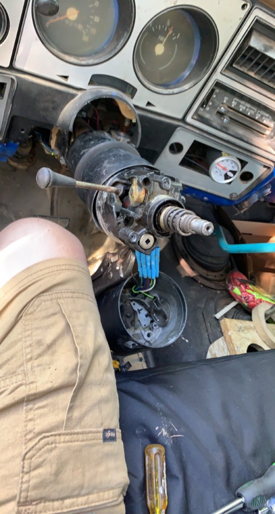

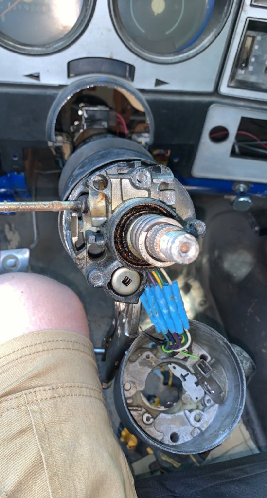

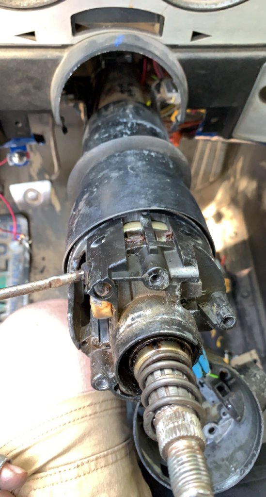

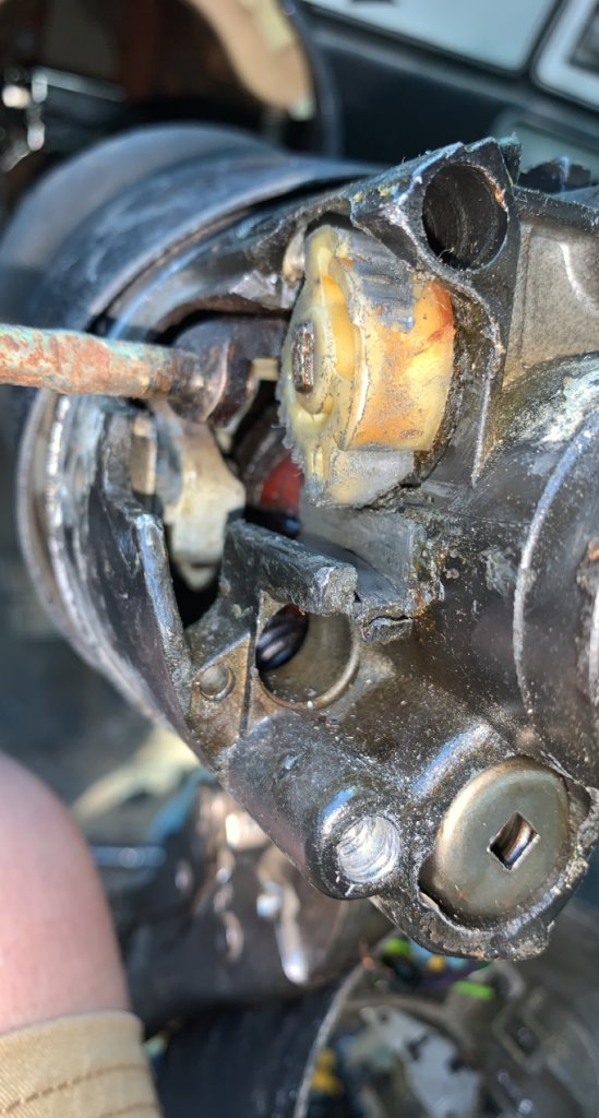

The “actuator gear” part broke, what holds the rod to the key cylinder. I don’t know how to get to the rod though. I’m sending pictures of how far I currently am. I don’t know how to get deeper into the column to get the rod out.

Yea the gear part I forgot all about those and I changed plenty of them back in the day. Ya that sucks not much a choice other than to tear it down at that point.
