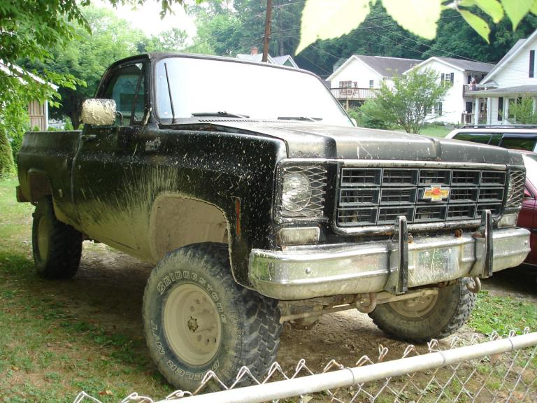

My truck on 33s and 4" lift...

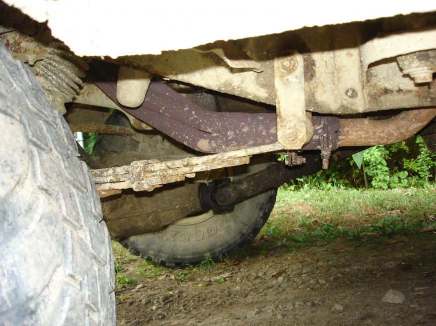

Ok guys, I took a few pics this morning.
The first one shows how it sits from the side (Looks like its sagging a bit in the back, though I do have an old seat and some other heavy crap parts in the back right now)
The second is of the front suspension showing the leaf springs

That is either a sagging 4" lift or a cobbled together spring pack from other springs yielding nearly 4" of lift. It's a little too flat to be like the 4" springs I've seen they usually have a little bit of arch to them. Here's the only pic I can find of mine...
attachment.php
You can see they have a couple inches of positive arch instead of couple inches of negative arch like stockers. I guess yours could be 2" but it sure fits 33s well.

I can say for sure they are 2" above stock. It looks like stock springs with the two lower leaves added in, they do not look like lift springs. A pic of the front spring eye would tell for sure if they are lift or modded stock. Either way, they are 2" above stock. Does it ride much stiffer than a stock truck?

The springs in the picture have absolutely no arch in them.
whoops ur right, mine still are a bit lower than that though and his spring pack is thicker. 2.5-3 then. besides if it has 3 inch blocks in the back it'd make sense to have a 3 inch front to be even like it is.
31,912
32,727
I'd still really like to see a pic of a front spring eye. That will show if it's a modded stock spring or not.
