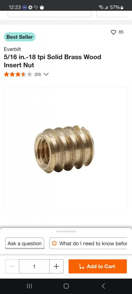

Those look similar to the studs used on the spoilers and flares on the F-body cars. Makes sense. I have a C&C dually with a flatbed, the dually pickups that I've seen the bed is butchered from the General to make those humps work.

Several manufacturers have used them in various composite parts. Some larger, some smaller. Junkyard shopping is the best place to find them.

This is probably the best view of how they work. My fenders were trashed and I took a sawzall to it before unbolting them. Studs thread into the flare, then the flare gets bolted to the fender. Mounting options depend largely on what flare you are planning on using.
