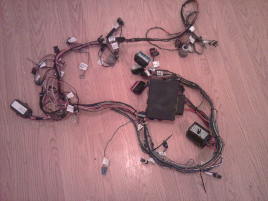

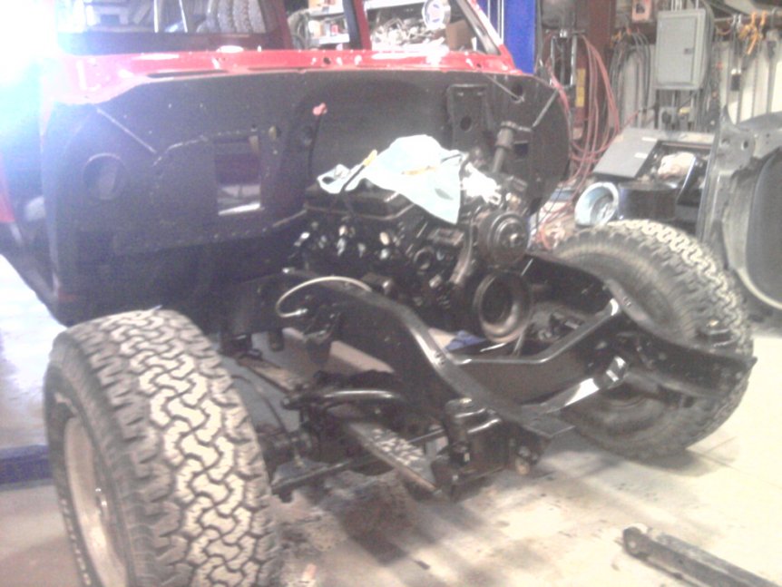

and then you need a wiring harness and computer with custom tune. I had oneluckypops a member here modify my harness out of a 96 Tahoe he does great work I sent him every wire out of my 96 Tahoe and he sent me back a custom built harness for my swap.
