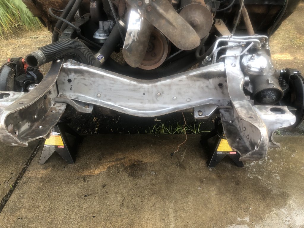

Current pic of the state of my73 c 20 getting ready to pull the motor noticed the fan pulley wobbles front to back about 1/8 of an inch that’s factree right? Sand blasting the frame like Johnny Cash one piece at a time

So is the wobble telegramming from the water pump shaft? Any play in the water pump shaft is a finished pump.
Do you have clutch fan? Maybe the play is coming from that? Also replace...

I can’t really tell on the water pump, I just have a standard steel fan it’s a 350 v8 if I grab the fan and wiggle it the pulley behind it is what’s moving
If I'm reading this right, your water pump is getting ready to **** the bed.

No it the water pump lots of movement in it thank you

@Gman73,
When you grab your fan, grab it with both hands and really give that thing a wiggle. Pull up and down on it to see if there is movement in the water pump shaft. If there is play in the shaft then, yeah replace the pump. I'm surprised it's not leaking from the seal by now. It must be full of rusty crud.

@Gman73,
Most water pump seals are spring loaded. They allow for some bearing movement. In this case the seal itself is still good. The bearing is shot.
Yes, replace the pump.

Will do, l like your comment about rusty crud that’s basically the whole truck, but I’m making progress

I'm confused by a few things here. Your picture looks like you have an inline 6 fan on it. Also, that's a K20 front end, not a C20. With the pulley off of the pump, can you move the mounting plate and shaft easily? Is the pump actually the problem? A factory 350 in a K20 should have a 5-blade fan with a fan clutch. The pump should have studs on it and the pulley should be sandwiched between the clutch and the mounting plate on the pump.

I agree with you it’s a 350 I believe someone swapped the fan at some point every v8 I’ve ever owned had a 5 blade fan. And it is a CK 20 4sp sm465 and 205 transfer case. I’ll remove the pulley and see.

What is a CK 20? A C20 is a 2wd, a K20 is 4wd... there is no such thing as a CK, since it cant be 2wd and 4wd at the same time. Was it a C20 that has been converted to 4wd?

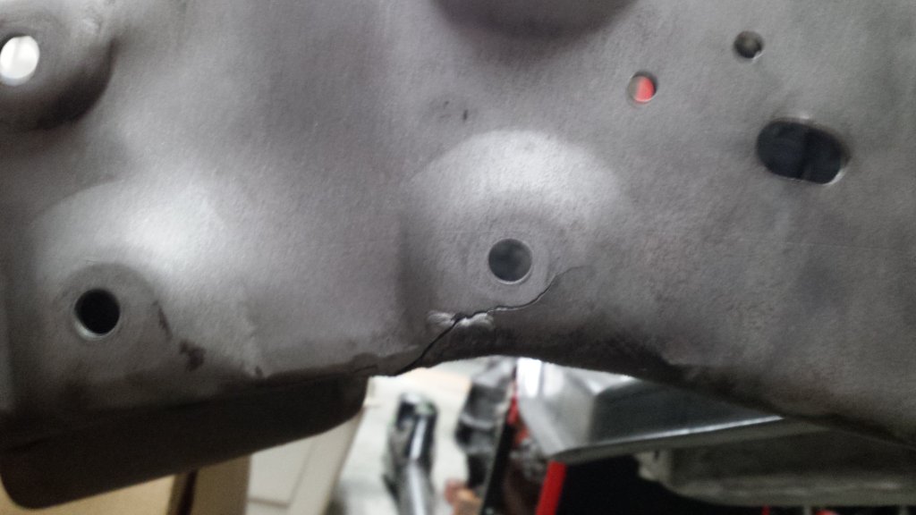

When you get that motor out if you are pulling it, Check all around the four bolts holding the freshly painted power steering unit. especially if the truck had non stock larger tires on it! This is what mine looked like!
