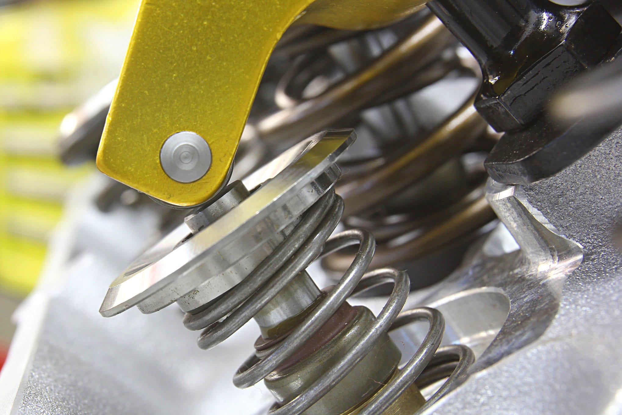

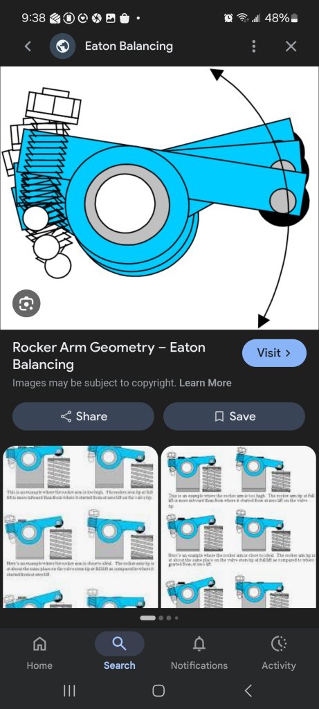

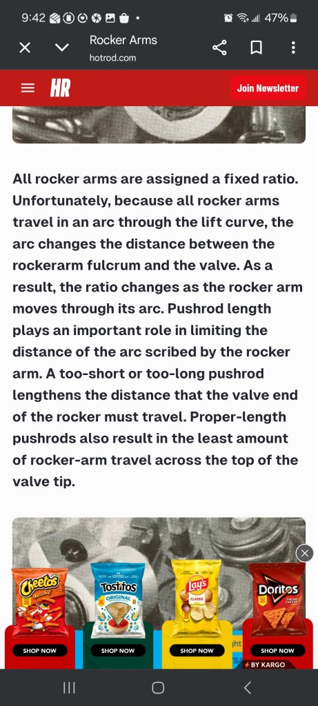

Valve geometry’s critical. I have a step by step for the 489 BB and will give a link. It is not to hard to do, and you may be fine, but if it were me, I would still check the pattern, go here: https://www.gmsquarebody.com/threads/bbc-489-build.45389/page-6 start at post 76. The goal is to keep the rocker on the center of the valve stem. Look at the pics.
