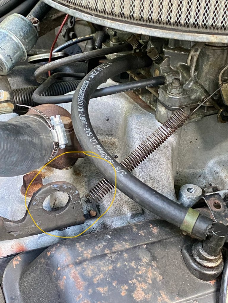

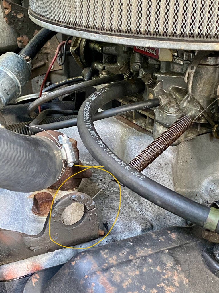

Hi! We previously had issues with our transmission and got it rebuilt a few months ago. So we are pretty nervous about messing it up! Does it matter where this spring connects? The carb was cleaned over the weekend and when we picked it up the spring was connected at the bottom of the metal piece, but before it had been connected in the loop. We are so new to classic trucks and I really don’t know much beyond what I can find on YouTube or the shop manual so I’m hoping wiser minds can give me some input. Thanks :)

Just a throttle return spring. No right way, as long as it returns the throttle properly, so it doesn't get stuck at wide open. It's all your personal preference on how stiff you want the throttle to be. It should be fine either way, looks like there's still tension.

Yes, it does matter, improper tension and or orientation of throttle return springs wear out the throttle shaft bushings. What carbureator ? On what truck? Better pic,no air cleaner. And proper it would be 2 springs 1 inside the other,not for additional tension but as a redundant spring. Hard to explain but imagine a tug of war both sides pulling on the same rope. You want your return spring pulling straight through as an extension of the throttle cable so the spring is pulling the throttle cable ,the cable is pulling the spring the carbureator throttle is just along for the ride. That minimizes the pressure on the throttle shaft bushings.

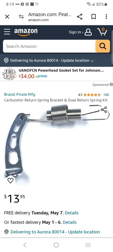

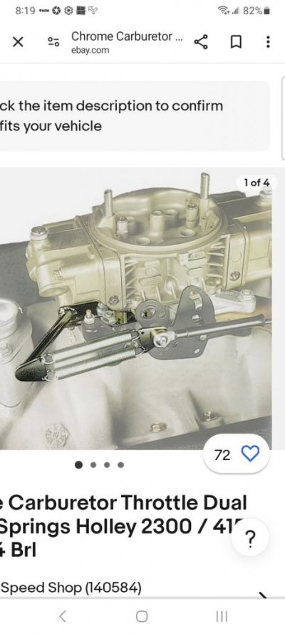

Best example I can show, and there are plenty of people that will argue the spring arrangement wears out bushings. Pic 1 demonstrates the straight pull . Cable pulling spring,spring pulling cable. No stress on throttle shaft. Pic 2 represents the spring I'd use and the type bracket I'd fabricate to get the spring into the correct plane.
So really I should have used the top opening on the bracket to get that spring more in line yes?
Raise it and decrease the tension on those springs.
