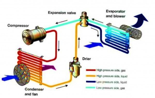

A/C is pretty simple.
Power goes from dash switch to the low pressure switch, to the high pressure switch to the electromagnet on the pump. If the pressure is too low or tow high, it cuts off the power to the pump.

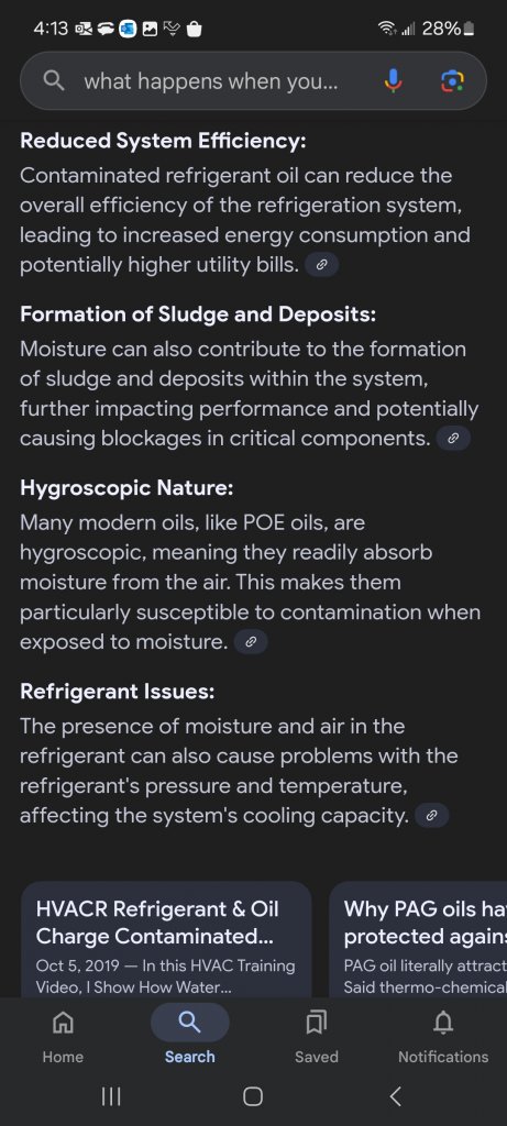

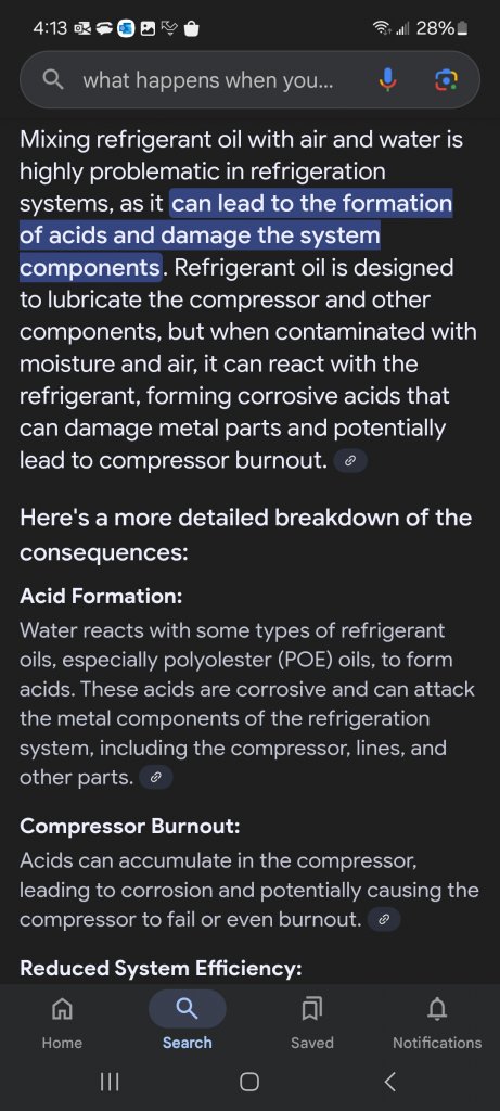

The refrigerant oil is hygroscopic,it absorbs water the water,oil,refrigerant mix,creates an acid I forget which acid I learned this stuff too long ago. The acid will destroy your compressor and eat up the evaporator and condenser,maybe not today,but eventually. Air and water in the system changes the operating pressures in the system diminishing overall cooling. Creating a vacuum removes the water and atmospheric air from the system. 1000s of certified AC technicians are not just doing it this way because it's more fun. Now unless you are comparing your low side pressure and your high side pressure as well as outside temp and duct temperature,you might not notice a restriction in the system and very doubtful you are going to get an optimal charge and optimal performance. The right equipment isn't that expensive some of it you can even make. FWIW I googled it right after I wrote this,for one to double check my memory,for another,no one believes anyone unless they put a pic from the internet up as proof,so here you go. First thing that pops up on Google is almost word for word,what I learned in classes 20+ years ago.
