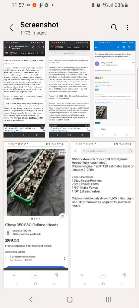

624 heads, super low milage,Plainfield Illinois . Not great heads but a bargain for somebody building a daily driver.Ebay auction and this the price for the pair. I hope helps somebody.

Oh I wasn't pointing those out to be a performance head at all. I wouldn't spend a dime or ten minutes working them. I just figured somebody on here has a beater that needs heads to get him to and from work. You can't valve job any head for what he's asking for a pair ready to go.
