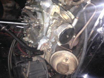

Was watching videos last night and figured something else out, I don't have the choke pull off on the rear of the carb, I rerouted all my vac lines where the should be, left egr disconnected, to use it I think I need a new part, it's a little plate with two metal tubes coming out of it, one tube is connected to the Choke the other is missing the tube, I'm assuming this is where the egr is routed to maybe?

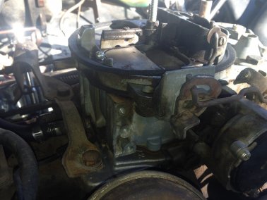

Somethings missing! Lol

That is just for a rear choke pulloff which isn't necessary.
Correct. No rear necessary or needed. Even though the casting has the place for it, I don't show that your carb number had one originally. Either way, you don't need it.
