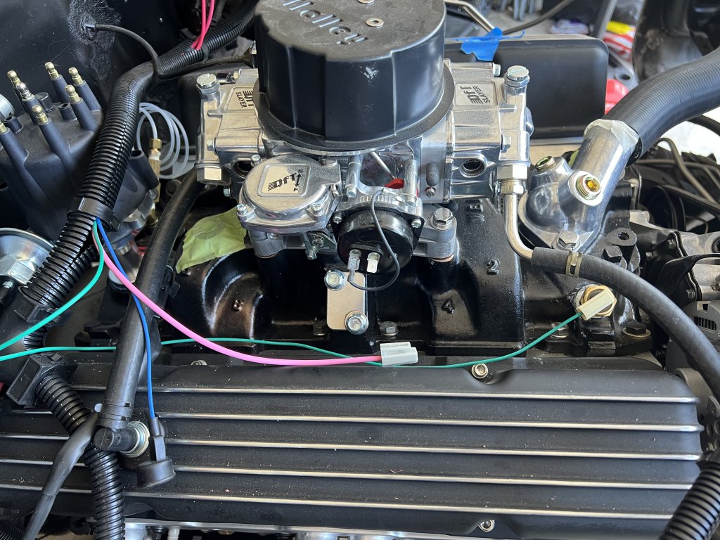

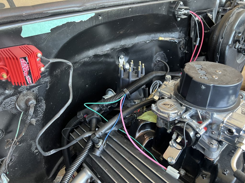

So if I’m wiring this correctly (the engine harness was missing when I got the truck), the pink wire would go to the choke, blue wire would go to the oil sensor, green wire to water temp sensor…

If you have an aftermarket harness that is supposed to mimic the factory one, then yes. The coolant temp sensor should be in the drivers side head though. Electric choke should be running through an oil pressure switch above the oil filter so that it doesn't start pulling the choke off until the engine is actually running.
The problem is that the port in my heads is 3/8”. I couldn’t find a sensor that would work that’s 3/8”. They’re all 1/2”.
So I should run a jumper from the oil pressure switch to the choke?
I would maybe run the power straight to the choke. Then remove the jumper from the ground plug to the carb body and replace it with a wire running down to the oil pressure switch. Then from the other side of the oil pressure switch to a good ground point.
This will be a switch that is NO and goes closed when it sees pressure above ~5psi or so.
You can get adapters to go from 3/8" to 1/2", but most new coolant sensors come in 3/8" and you have to use an adapter to go the other way.

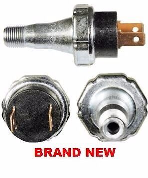

So I would use a switch like this^^
Run my oil sensor wire to one connector and then run a wire from the other connector to the choke?
Bextreme04
May 13, 2019
4,192
5,096
350-4bbl
Oil sensor wire goes to an oil pressure sensor. Full stop, the end.
Then, completely separate from the oil pressure sensor:
Choke power wire would go to one terminal of that switch, then the other terminal goes to the choke.
OR
Choke power wire goes to the choke, then choke ground goes from the choke to one termianl on that switch and the other terminal on that switch goes to a good ground location.
