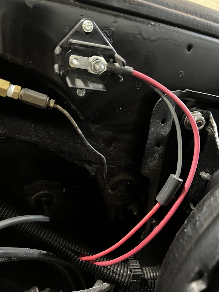

The rotor is turning.
Ok. I’m missing something here…
The distributor connects to the blaster ss coil via the distributor’s 3-wire connector (which becomes 2 wires at the coil) and the main center plug.
There’s nothing else connected to either.
How do they get their power?
Do I need to run a wire from the junction bar on the firewall over to the coil?
My battery positive is connected to the starter.
My wiring harness connects to the starter and the junction block on the fire wall (and the fuel sending unit, water temp sensor, etc)

Can't really tell anything from your pics. What happened to the factory wire harness IGN+ wire? A '77 model year would have been factory HEI, so you should have a solid 12v source wire right there to tie into the coil. According to the summit instructions you wire the distributor like this:
My guess would be that the factory HEI 12v+ should run to the coil +, that will then power the coil and the ignition module in the distributor(through the red wire in the pigtail). The ignition module in the distributor will then fire the coil using the orange wire in the pigtail.

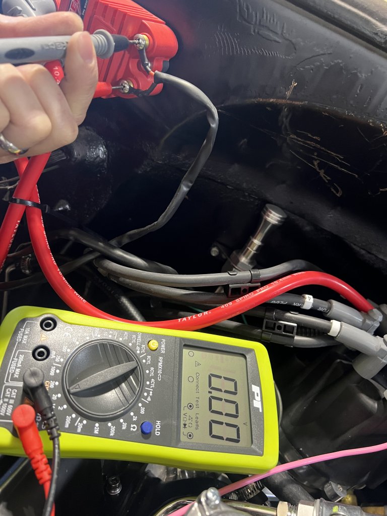

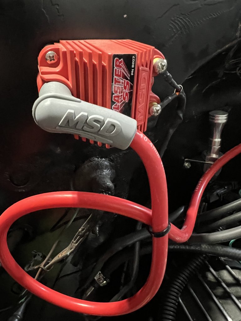

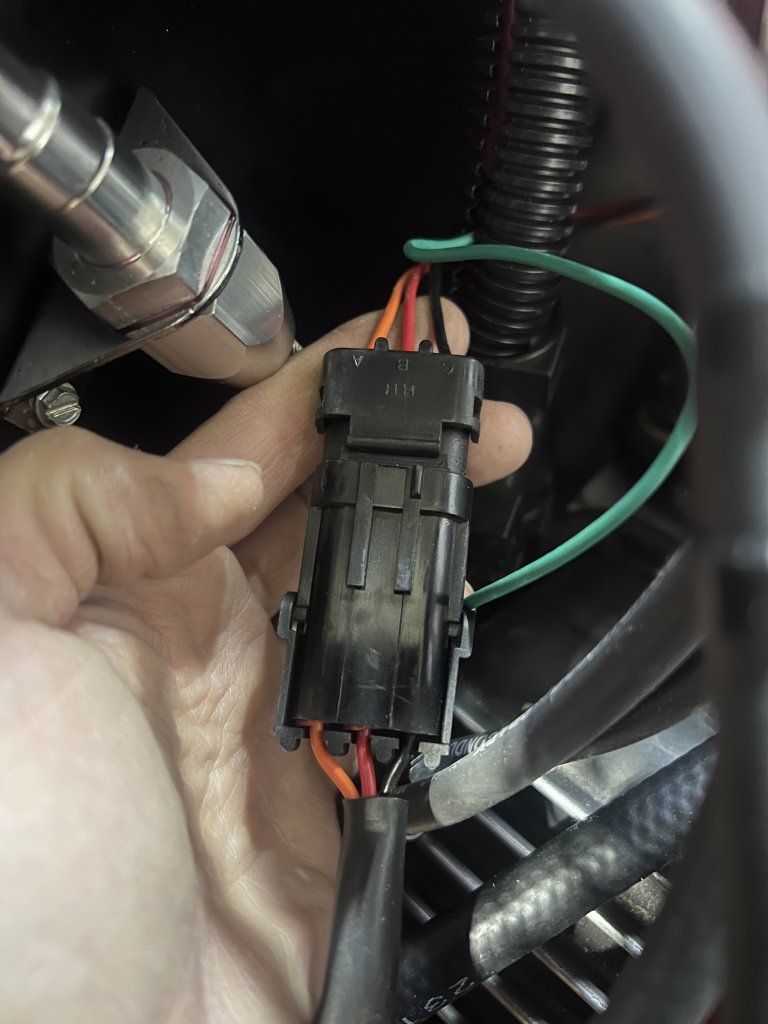

When I got the truck it was in bad shape. It basically had the short block and trans.
I had to buy a new engine harness.
The distributor and coil are wired together correctly through the supplied pigtail and the center power wire.
With the key in “on” position there is 0v at the + on the coil.
I still don’t understand where the coil or dist. get their power.
They’re only wired to eachother.
I must need to run 12v from somewhere to the coil??

You will need to locate the +12 IGN wire in your harness (should be a slightly thicker wire than most others) and it should have steady +12v with key on and while cranking. Connect that to the + side of the coil.
From what I can tell that Summit distributor is a pertronix type unit, basically a points style distributor converted over to a magnetic pickup. Reading the instructions it seems they have bad information saying to remove all old wiring from the coil and just connect the new harness to it.
