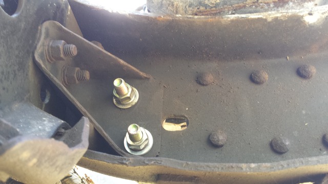

Here is a picture if it shows up , it is where the two new bolts are at .
Also - 3/8" grade 8 bolts are the factory repair for missing or mis-hit rivets, so they would be fine for a repair out in the real world.
