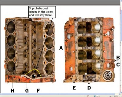

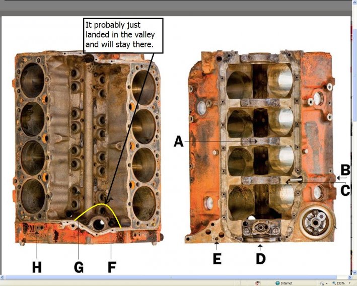

It probably did not even get down into the pan. I bet it's just in the lifter valley. If that is where it ended up - let it be. It will just stay right there until the engine is scrapped.
The only thing that you do want to check is that it did not fall in between the slots of the oil pump shaft. That would prevent you from restabbing the distributor.

Thanks. I cleaned the seating surface and flushed out the distributor hole with a couple quarts of clean oil. I didn't get a chance to put everything back together yet, but it looks good. Didn't spot the gasket chunk coming out, but it sure doesn't look to be on the oil pump shaft or the distributor drive gear on the cam. Thanks for the image of the block, it helped.
