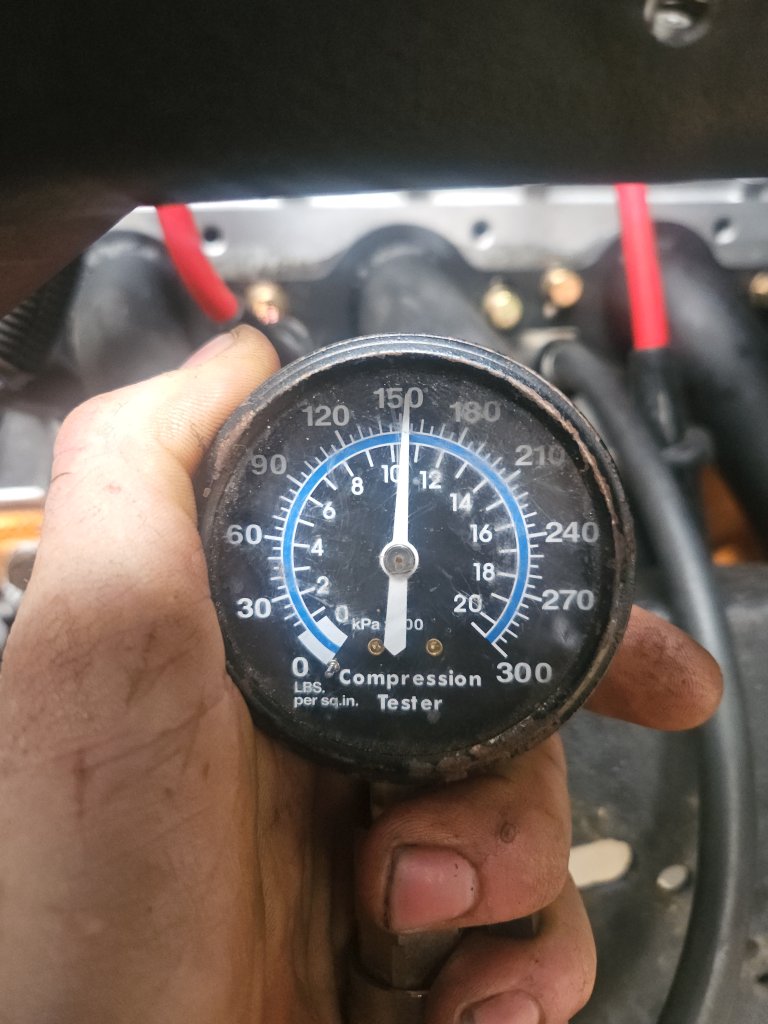

What would cause a dead cylinder only 1 after warm up I've replaced plugs wires coils cam sensor cleaned crank sensor checked push rods springs and rockers

Check compression.

Im gonna say your compression for that cylinder is good looking at your picture. LS engine in the same picture I would look at the injector. Swap it for another and see if it goes to the cylinder you swap it to.

U did it's holding at 150

Isn't 150 a good number for compression? Definitely not dead

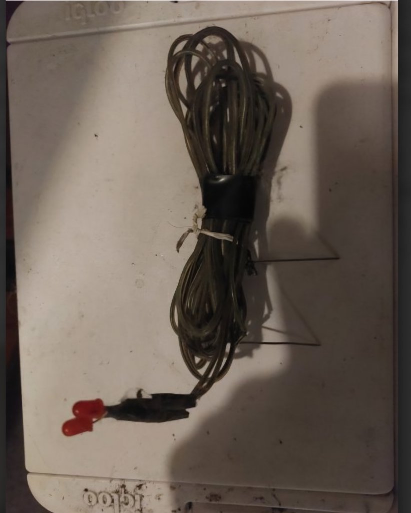

Make a noid light. A piece of speaker wire,2 t pins 2 leds,wire 1 led in each polarity use the t pins to back probe the injector connector,see if signal drops out while running. Mine is extra long so I can put it under the wiper and watch while driveng. Put a timing light on #5 see if spark drops out hot. Also did this engine originally have AFM?
