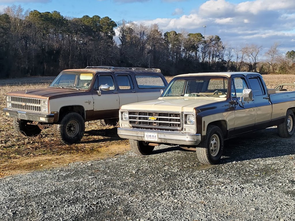

I wish that I had a "good" answer but I do not. My dad's old 79 C20 is a 350/SM465 with G80/GT4 14FF. He ordered this truck new here in central NC and used it until he retired.
I just recently sold an 81 K20 Suburban that was a 12,000 Trailering Special. The gear ratio was NOT listed on the SPID with the truck and it was equipped with a 10 bolt front and 14 SF rear. I thought it weird to have the heavy GVWR but have the SF rear. It was a Silverado with factory tach and gauges, heavy duty front springs, engine oil cooler and all power creature comforts. It was also a 350/TH400 truck with the smaller radiator. It was definitely different.
