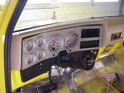

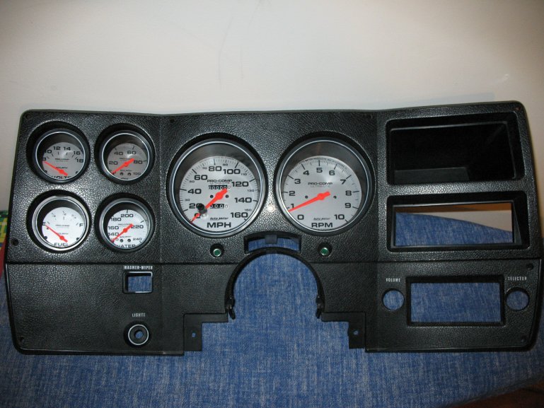

These are a couple of pictures I had on my computer.
Top is the way to go IMO. Yeah it is a little bit of work, but I think it is worth it.
Bottom one, personally I don't care for, but your opinion may vary.

That was my plan was to. Modify the stock bezel with a new center piece made of 1/8" abs plastic. As for the angle of the gauges I was thinkin of getting some gauge angle rings to angle them towards the driver better. Only problem is the speedo and tach don't get rings because they don't make them. I think they are big enough though that it won't be a problem. Like these..
http://www.amazon.com/gp/aw/d/B00062Z6OC
The idea was for mine to look more like picture 2 with a couple variations.
