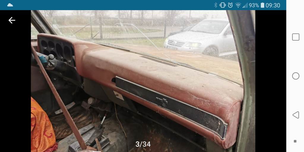

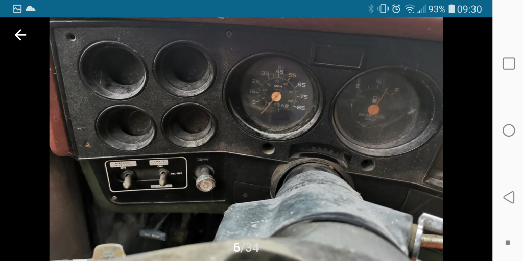

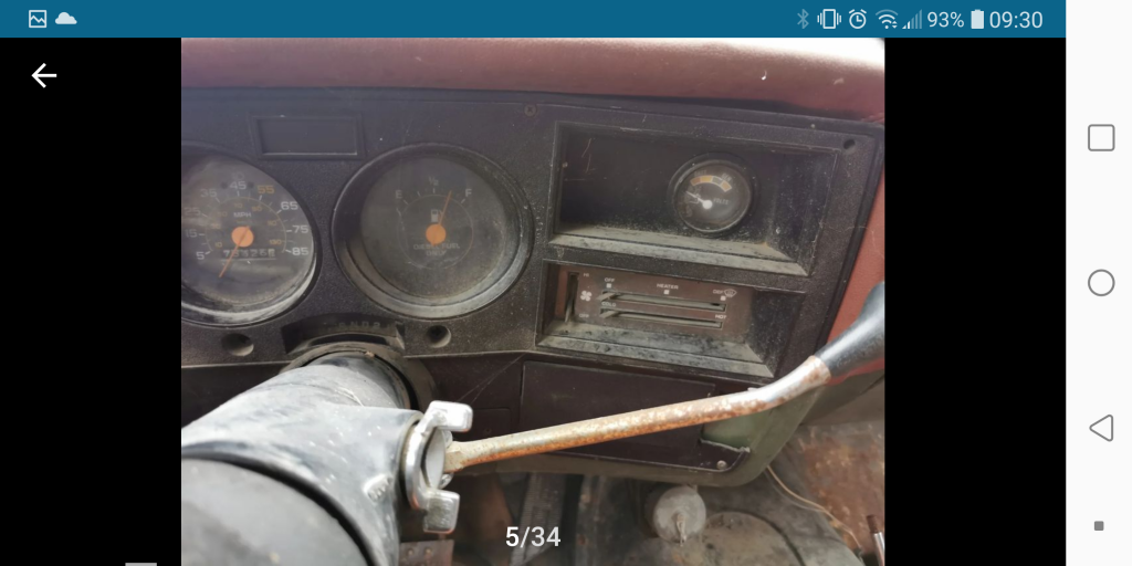

I want to add a thing to this old thread as I'm looking at a CUCV Blazer and it appears that it has no cabin ventilation. Dashboard has no vents and there appears to be no climate controls. I guess this means no cabin heat, this may be important for someone willing to use one in a winter

You have a non AC truck. They had no top vents. You have heat through bottom vents and defrost vents.

I didn't know that. I was not aware that no A/C meant no dash vents. When I zoomed in I can see that there is a heater contro that I didn't notice, it's just the vent which is missing. I guess my post can be deleted
