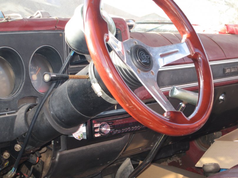

k15
Here is a pic of my cc on my non tilt wheel. The tilt column uses this exact lever.

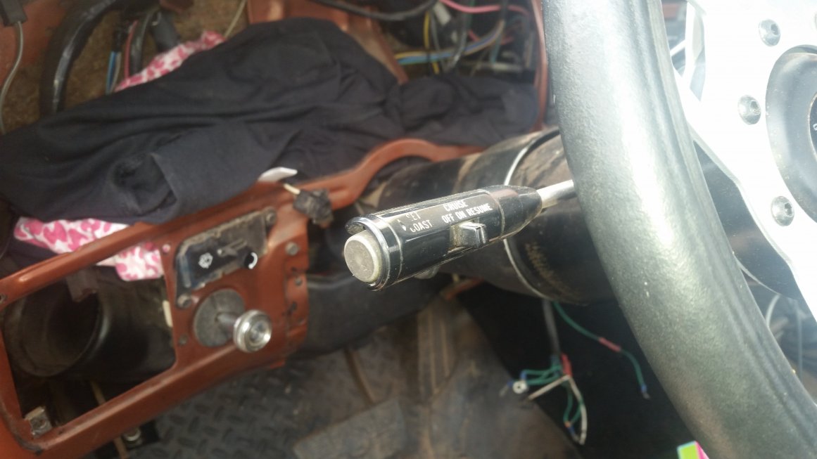

Scott
383
Sorry this took so long. This is on a 1982 K10 Pickup. The tilt lever is hidden behind the cruise/blinker lever in the pic but it's there.

k15
There's a lot of words in those last couple of posts but I don't see any pics... Please :)
I just ran into a problem trying to install my tilt wheel. You need to pay close attention to the end of the shaft. If it is a splined shaft it probably won't work with a shaft that has the bolt through the middle. The splined shafts were 78 - earlier. They might have been installed in an early model 79 though so you will have to look.:)
