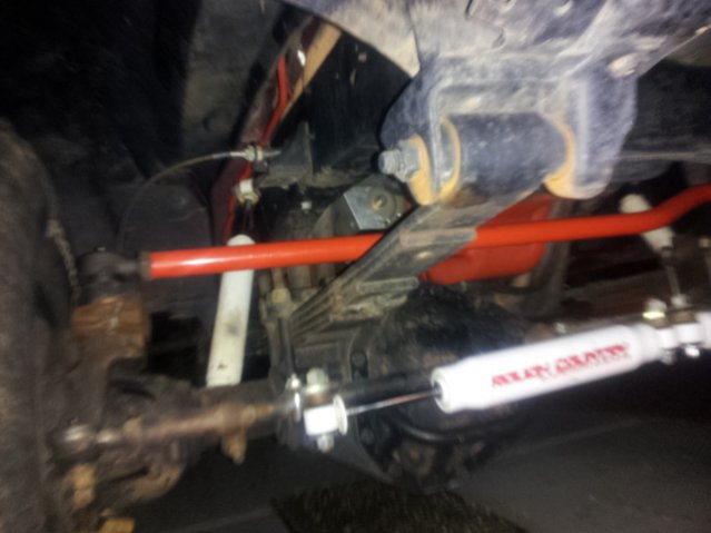

NOPHO84K30
Feb 28, 2013
482
104
north phoenix
justin
1984 silverado k30
K30 dana 60 corp14 ff
454 sm465 np205
Ords cross over on mine
