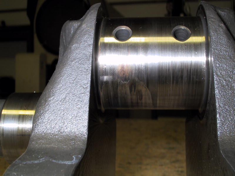

This might help as far as judging the crank...
Unacceptible on left, acceptible on right
attachment.php
You can see where the rod "slapped" the crank in the bottom portion of the left journal, distorting its roundness. As far as the right one if everything mics OK and you can get 0.002" clearance that's all you need.

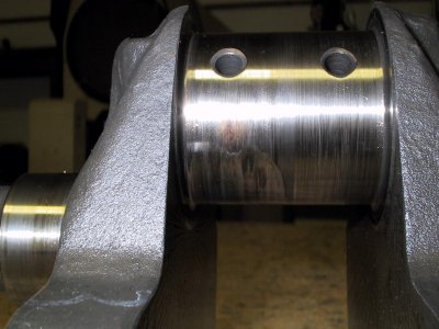

attachment.php
That crank is beyond just polishing. Likely to clean up at .010/.010 though. :waytogo: Hopefully his won't look like that though. Sounds like he might have caught it in time to save the crank and just go with new bearings and oil pump.
