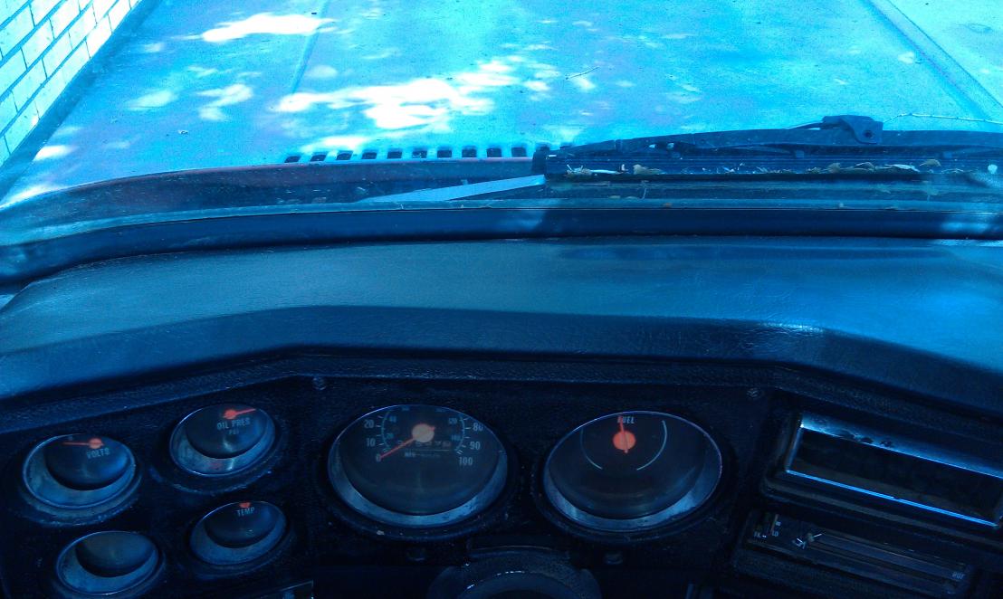

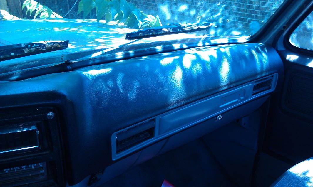

Some pics of this process would be cool if you have them. We like doing how-to write ups with pics if you ever find something to add. :wave:
Even some before and after if that's all you have.
here are some after pics.
