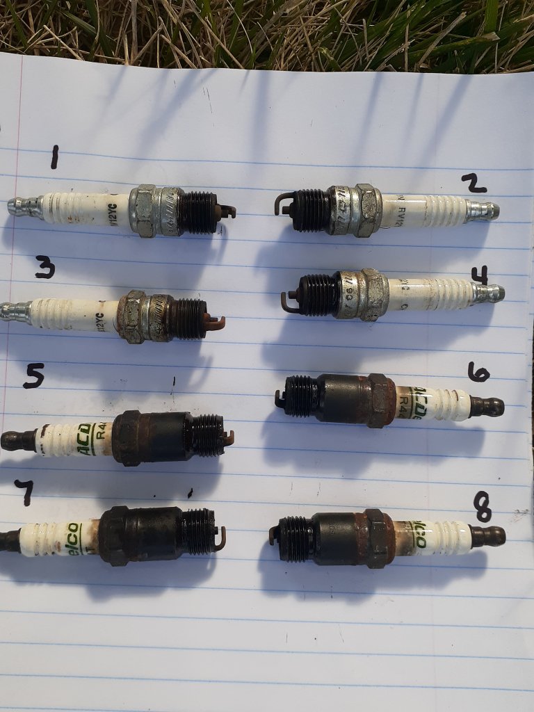

I did the compression test this morning. I warmed the engine up first. On first attempt to start it lock up. I knew #3 had water in it before. I pulled #3 and water ran out. I mean a lot. It started after #3 was cleared.
Readings are as follows.
1 - 150
3 - 135 water in this cyl.
5 - 155
7 - 140
2 - 160
4 - 80
6 - 85
8 - 150

Do wet compression on 4 and 6 [4 - 5 squirts of motor oil]. If it comes up near the others, needs complete rebuild. If they stay low might get by with heads. Water usually caused by head gasket or cracked head.
At the very least heads need to come off. However, if it were mine, I would get a long block.
Will add, a flat can or valve train issues can cause low compression because it may not allow proper air flow in and out. Either way appears a replacement motor is in your future. Don't toss good money after bad.
