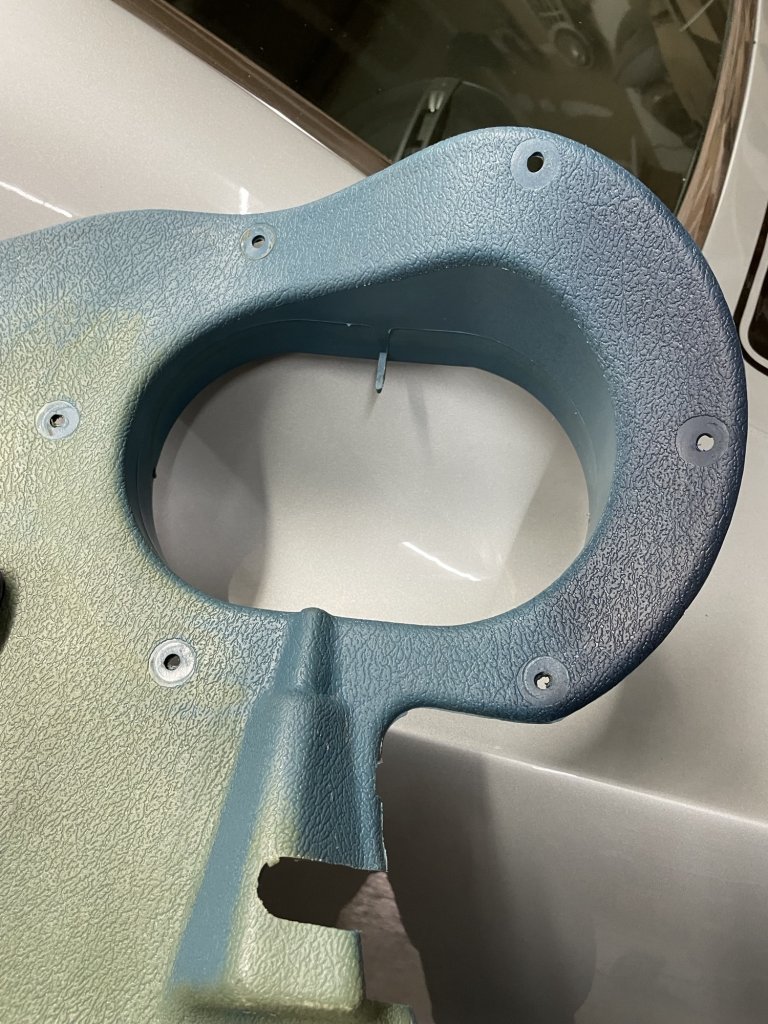

I’m looking to repaint the plastic trim on my 1977 Cheyenne with blue interior. LMC only lists Colorbond-blue 37-8382. I ordered some but it’s not even close. The attached picture shows the original color in the middle. Left side is sun faded and the right side is the LMC color. has anyone found a good match?
Thanks,
Jeff

Before your blast LMC or any other manufacturer about how off the color is. Remember, your truck is 45 years old. Lots of sun damage over the years. Grant it we live in the PNW and have less sunny days than cloudy days. But interiors do fade.
You can see on the door panel how different surfaces fade,
The top of the panel is almost white and cracked. The armrest is different from the door panel, and the pocket is still different from the rest. As far as I could tell these were all original to the truck. The kick panels about as light as the back edge of the panel since they were close to the seat.
The seats are yet different as well...
I would pick a blue that you like or close to what you think the original is, clean the panels, prime them, then paint them.

Not implying LMC is at fault just want an accurate match if I can find it. Hoping someone has worked to match the factory shade.

Colorbond has a pretty broad line up of different colors. Look at Ford and Mopar colors too. They may not be official GM colors, but there is bound to be at least one shade of blue that is close or exactly like yours. I remember one thread where a guy had to use a BMW interior color to match the factory interior color on a '65 C10.

I had an auto paint supplier mix me a color match to the back side of a trim panel that never would have been sun fade. So I can paint but I‘m worried about the flexible parts not holding up I guess. Just seams odd all the parts are showing up this shade of blue? I’m missing something was this dark blue available at some point? I can’t find it as a option for 1977.
-Jeff

The hard plastics like door panels should be fine, the soft bits like the dash pad could be a little more challenging.
knowing GM being the oddball that it is, it's entirely possible that they offered two different shades of blue in the same year, and used the same codes for both. Either that or they aftermarket companies don't think there's enough light blue Interiors to bother with a correct color.
