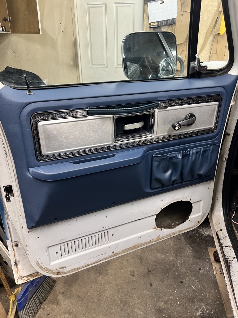

Well, There must be variations or maybe sun fade? I used the Blue ColorBond from LMC. For me it was a perfect match, but the second Pic is also an ‘84 and its interior is a lighter shade. So I guess you have to find the one that suits your purposes.
Yours looks fantastic. Mine is also the darker blue ... I appreciate the visual ..
As mentioned, I plan to try USA 1 in the 81-87 range ... I have a few pieces of plastic trim I got from the salvage yard to practice on before actually using my interior trim pieces.
If this does not work I will try the LMC ColorBond ... USA1 image below ...
Thanks !

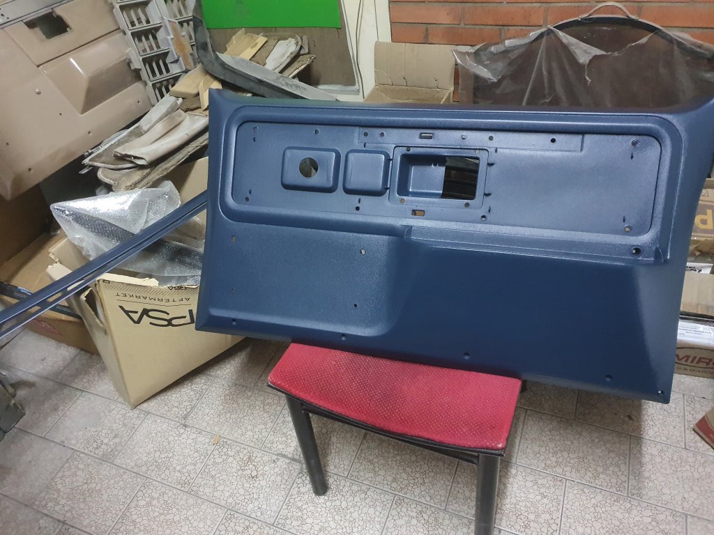

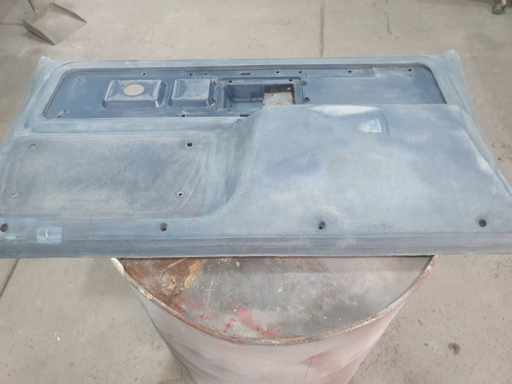

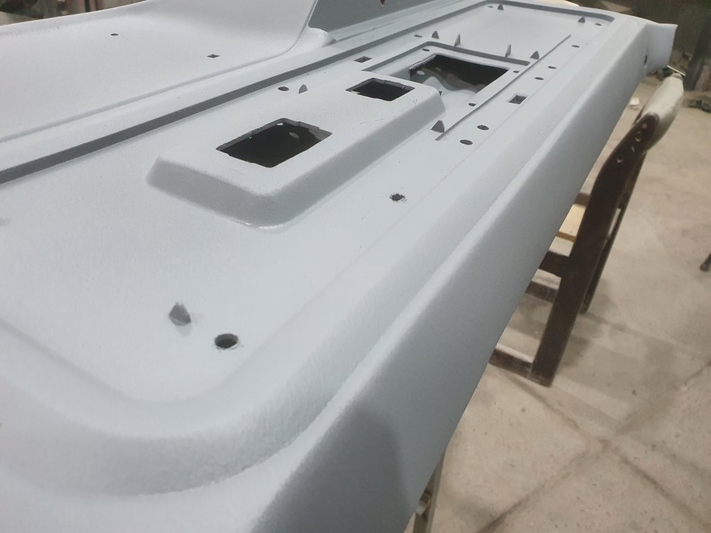

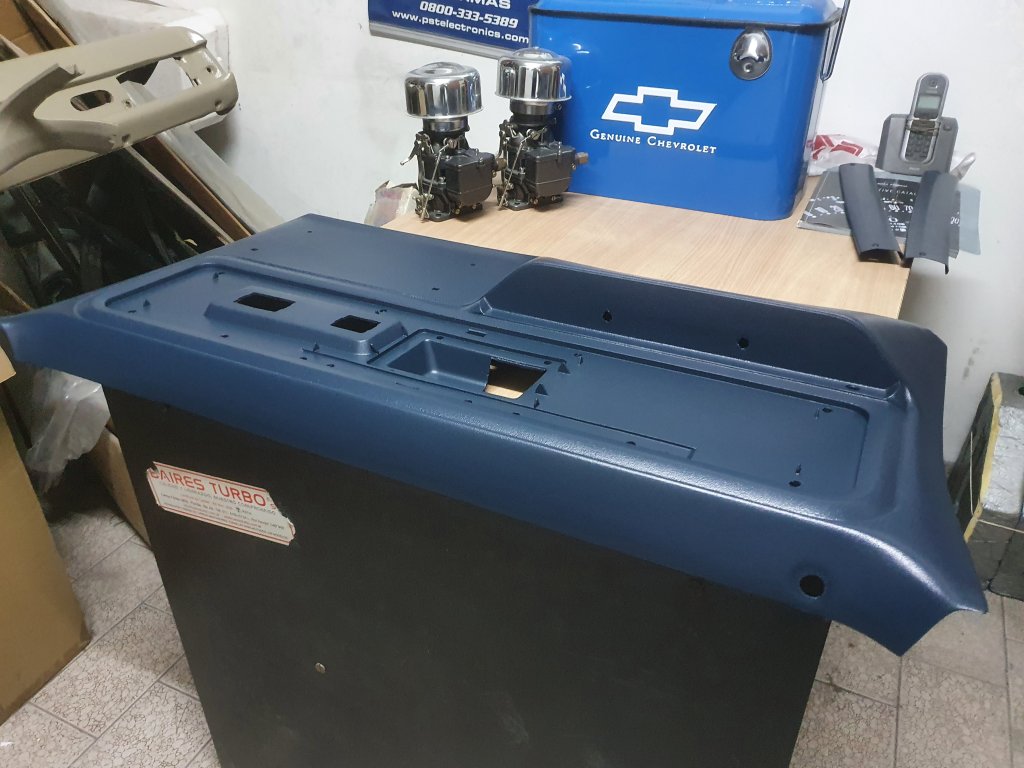

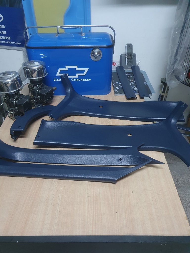

Someone has to have ran into this issue before me? How did you handle restoring a blue interior.
question, can't you prepare the color in polyester bilayer for automobiles in a paint shop, here they prepare it for me with a sample of the same tone, then I paint and that's it
nicoargentina
Feb 14, 2024
32
124
Quilmes Argentina
Nicolas
4.1
Look

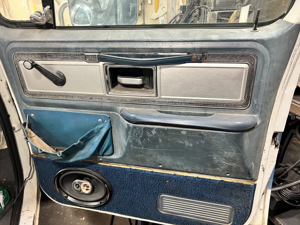

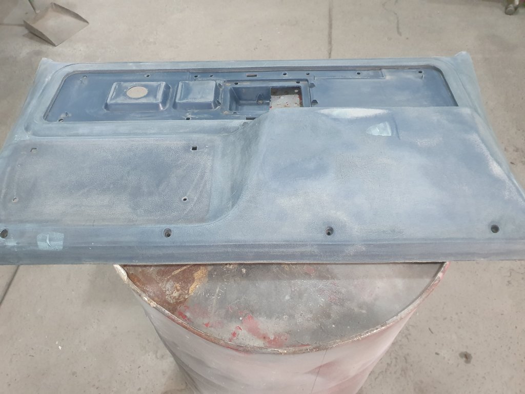

I’m looking to repaint the plastic trim on my 1977 Cheyenne with blue interior. LMC only lists Colorbond-blue 37-8382. I ordered some but it’s not even close. The attached picture shows the original color in the middle. Left side is sun faded and the right side is the LMC color. has anyone found a good match?
Thanks,
Jeff
