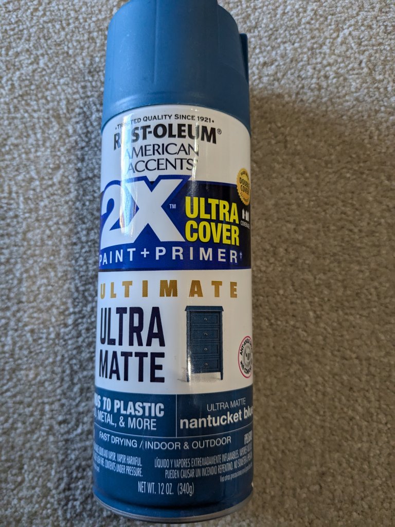

I struggled to find the correct color paint for my 1977 Chevy C10 Medium Blue Door Panels. Finally found almost perfect color match. In fact, I sprayed a portion of the inside of the unfaded portion of the door panel, and my wife couldn't even see where I had sprayed. It is Rust-oleum American Accents 2X Ultra Cover Paint + Primer. It is Ultra Matte Nantucket Blue. It's designed for Plastic, not designed for vinyl or fabric. I think it will work great on the door panels. See attached picture.

May want to get more than 1 depending how much you’re spraying. It goes quick. 2 full door panels is likely to use more than 1 can.

Hi Jeff, I was wondering if you found a solution to your color matching issue. I have a 1977 c20 with the same interior color as yours and have experienced the same problem.
Thanks in advance,
Nick
nwessel77, I did find an exact match. Posted #39 on this thread. Rustoleum American Accents 2X Ultra Cover Paint + Primer Ultra Matt Nantucket Blue. I painted my '77 Door Panels and they were perfect.
