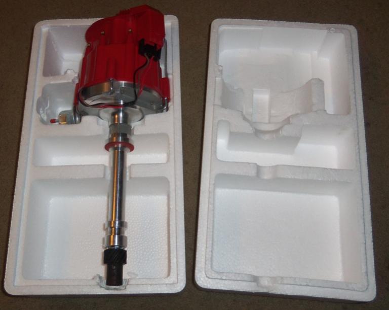

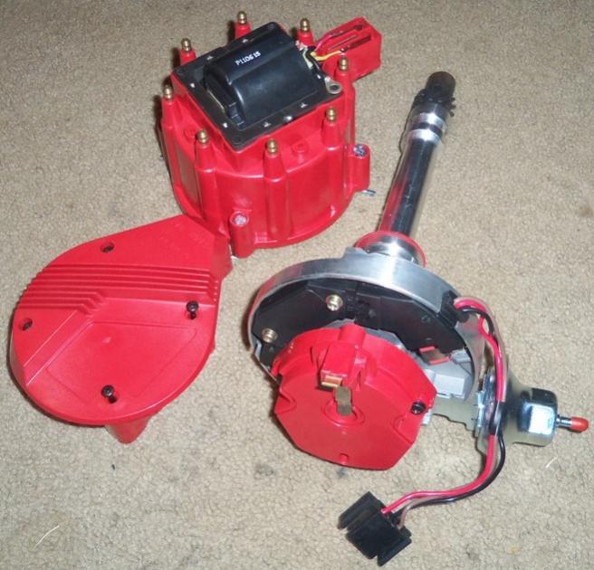

BTW, I found my pic of my cheap Skip White Dizzy I got off ebay. I should have gotten your style with the OE type coil cap. I've since changed mine. This on here is a PITA. I'm pretty sure these are all Pro Comp distributors made in China. They're not bad though. Careful on Intake manifolds though. I hear it's common you have to gasket port them yourself to make the ports match up, and sometimes, they've gone out of bounds and you'd have vac leaks. So some Pro Comp is OK, some is not. So far I hear the dizzies are fine.
And normally, Red is color for MSD or Mallory, but these are NOT Mallory or MSD. But they are brass terminal caps.
