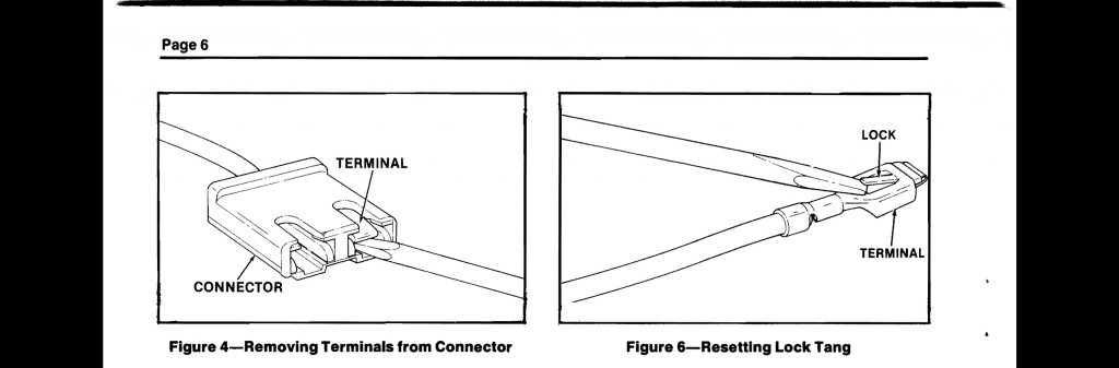

OK - inquiring minds want to know on this one:
You used the phrase "de-pin the connector" very casually - as if it were something that could be accomplished by mere humans.
How the -censored for my protection- do you actually do that without destroying the connector and wire ends? The one time I tried to get one of those things apart (only 3 wires, much less than the one in question here) I ended up destroying all of it and had to find another one to cut and splice the wires onto.

The metal terminals will have a tab (tang)- you push the wire as deep as it will go from the back into the connector .-this causes the metal terminal to be as far forward as possible. Take a very small flat head screwdriver (or something similar) and push the metal tab down - when you are pushing the metal tab down you pull the wire out. Takes a little practice but once you do a few it becomes easy- see attachment

Like @Broken85 @Jgonick @Gpaw44 said... There is a small lock tab on the connector, push the wire into the plug, depress the lock tab with a small tool and gently pull the wire out. Before reassembly, ensure the lock tabs are bent back out so they latch when inserting the wire some lock tabs are springy and go right back and others need persuasion.
There are some connectors that are an absolute PIA to do this with so I understand where you are coming from, but the turn signal connector isn't too bad. Actually... Now that I think about it, these GM column turn signal connectors are where I first learned this skill.
