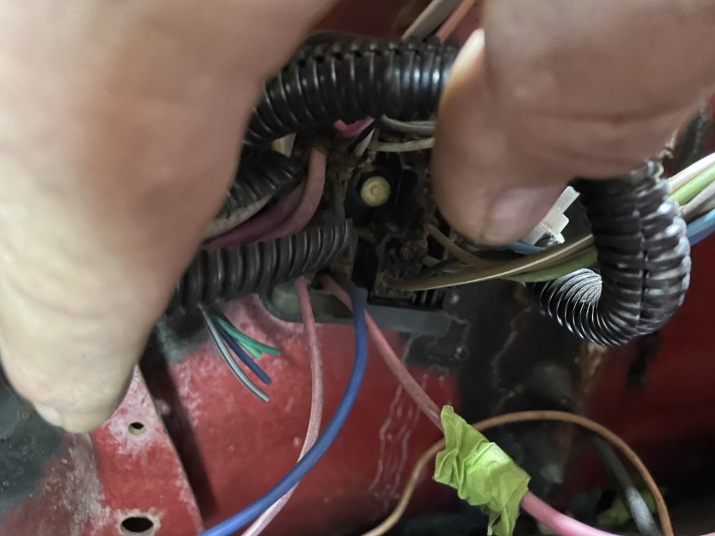

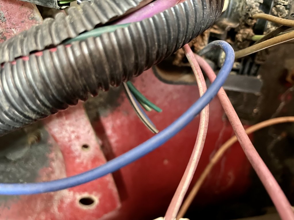

Yes sir it’s blue. I think it ties into the oil pressure switch if I’m reading the diagram right. No guarantee there lol. I’m still trying to sort out what the last pink and pink/white wires are for. This harness came off of a later model. 84-85 I’m not 100% sure. I was just happy I found one intact in good shape.
these wires are unlikely to be enough current for your thing, and a pressure switch is a one wire deal unless its got 2 i think, but im pretty sure thats not a 12 volt source.. i could be wrong.
I would just do a fuse tap, find it at the auto store, and then run a new wire. you can use an used circuit or one that is key on

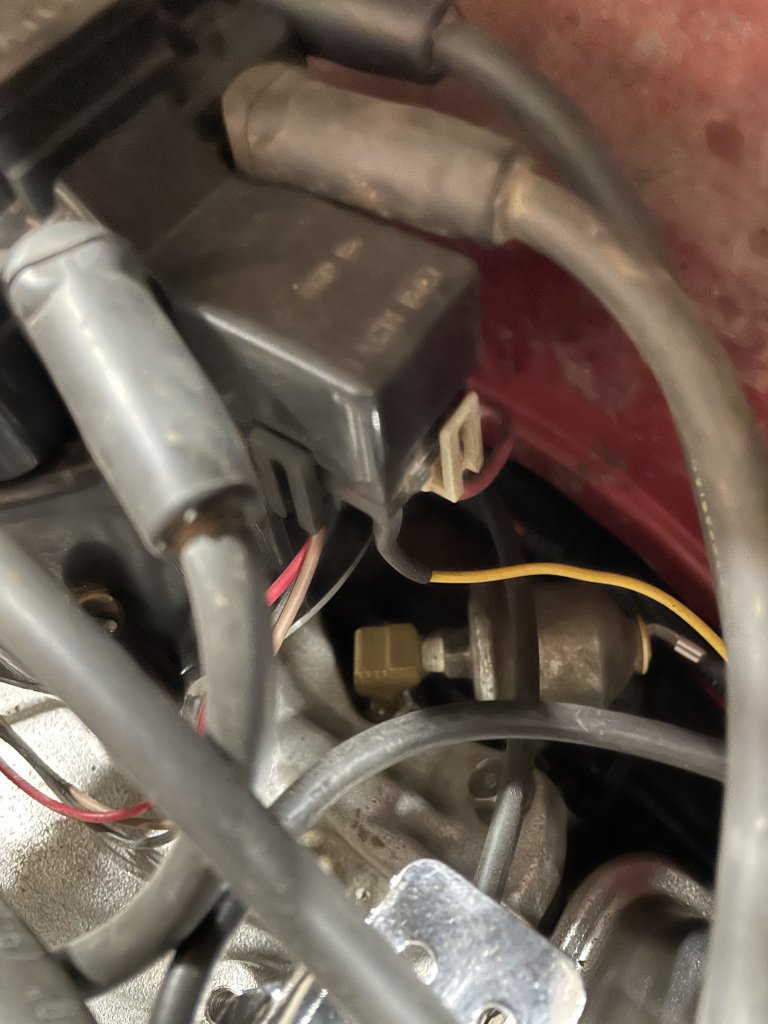

The first picture shows the oil switch that provides power to the choke only when the engine is running. It is the smaller switch on the back of the block.

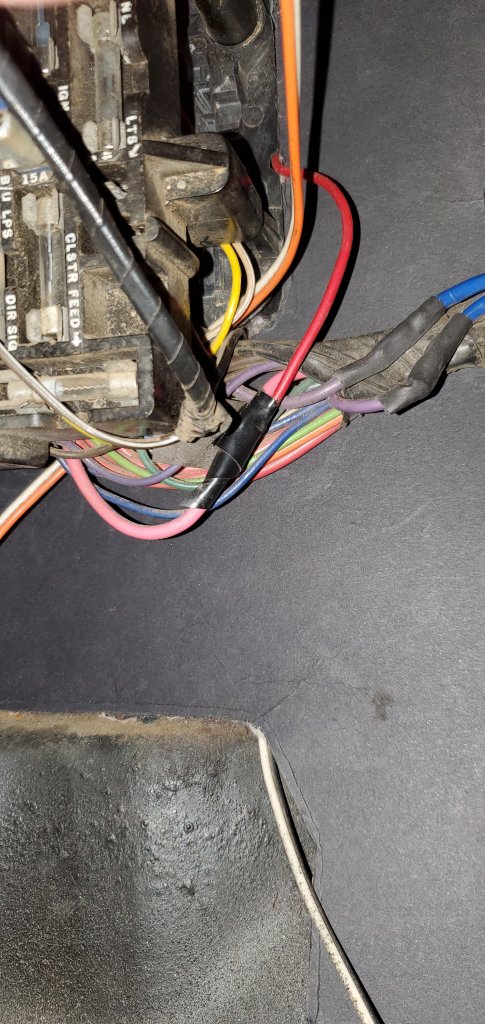

I recently connected my choke wire to the inside of the cab. It was easier to find an ignition hot wire next to the fuse block.
It's the red wire connected to pink. Reminds me I need to make it a little nicer.
