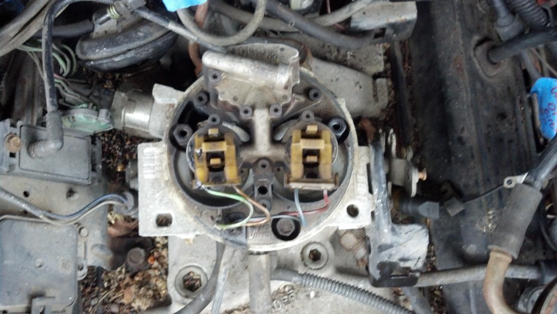

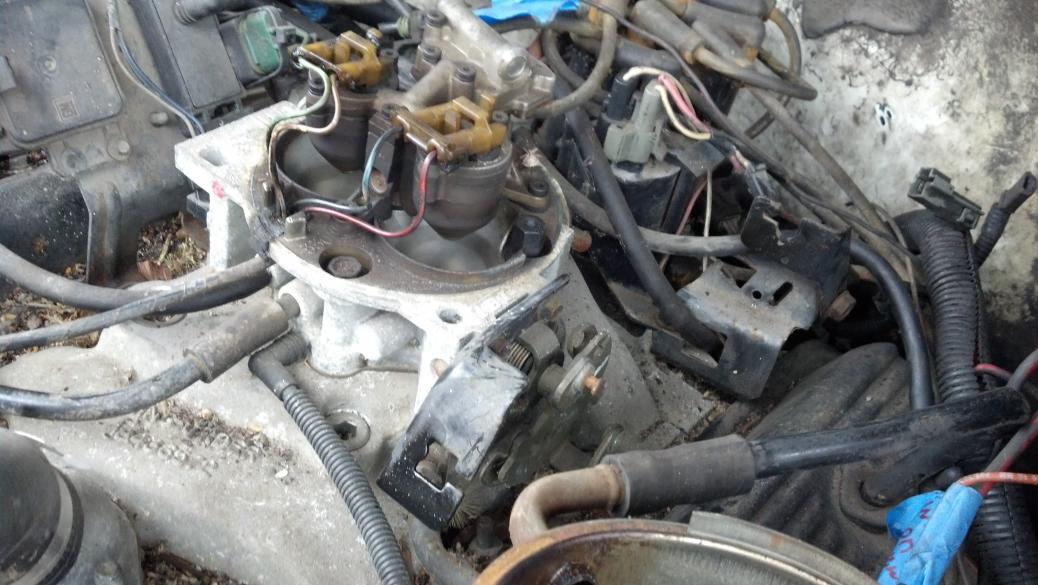

more pics...

Wow, that looks like a much later throttle body...like 90+
Does this truck have a PTO on it? Thats the only reason I could see having that bracket on the front of the throttle body, for a speed control cable.

Nothing currently or that I've seen may have been. Just electronic brakes. This gonna be an issue?

Nope. Like I said earlier, you will have to find a throttle body with the proper linkage.
Heres a suggestion. I have a proper throttle shaft to send you. I think you should take the shaft, and the throttle body to a machine shop, and have bushings installed, along with this throttle shaft, and then your ready to rock.

What years for throttle bodies would work?

since you have the round TPS plug, I would say 1991 with 700r4, or anything truck with that trans 87-91 if you dont mind changing the plug.

Same number of pins right? Just cut and splice the plug?
....if I find a 87-91 350 with a 700r4...couldn't I pull the ecm and tranny lock up wires? Or is it a different harness all together?
And any provisions I need to worry about for cruise control?

And can I get a photo of what this throttle plate is supposed to look like so that I get the right throttle body

Thanks man :) I'm gonna hit my favorite yard. They have around 20 trucks and suburbans there between 87-91
yup, just splice, same wire colors.
dont worry about cruise unless you have it. it can be added.

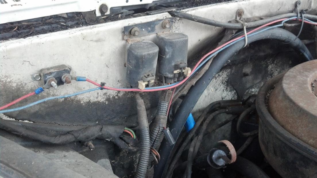

Just to make this a little easier for me can u identify these? I'm assuming fuel relay is one
The one on the right is the fuel relay with that red wire with plug, and the one on the left is the kickdown relay for the TH 400.

Thank You,every bit of information helps.I was`nt sure what that relay was for,the one on the left.
