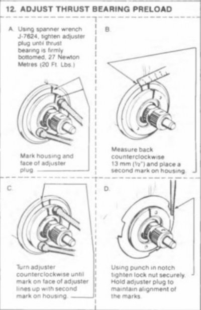

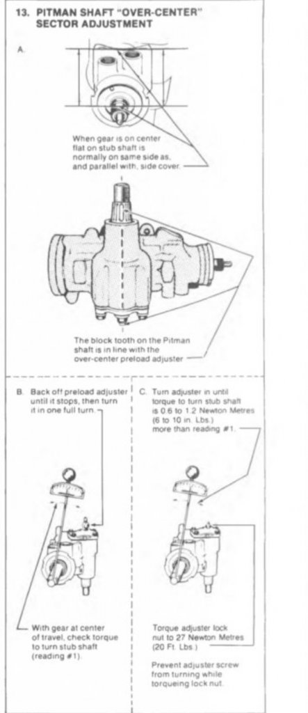

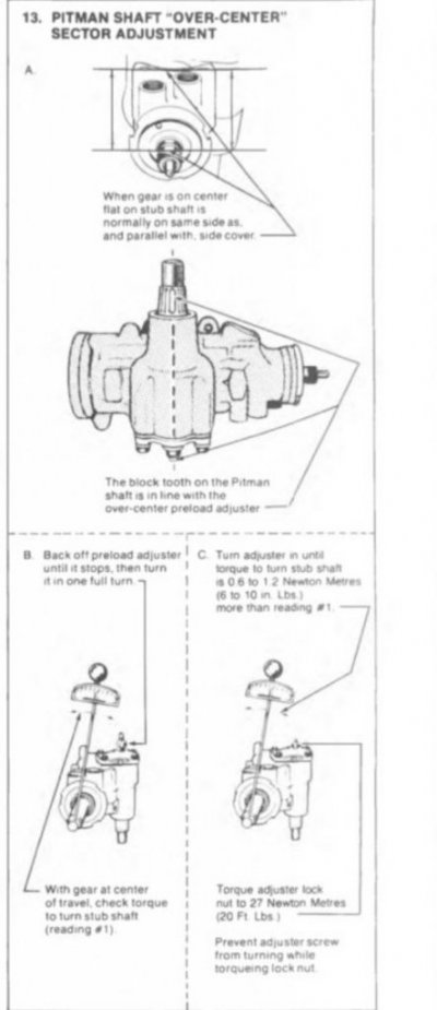

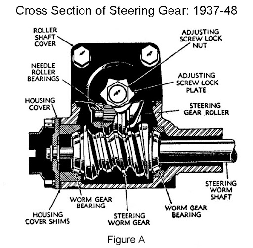

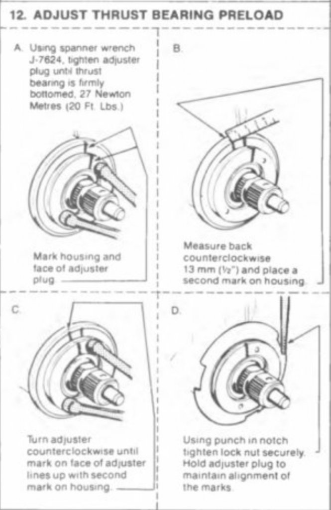

I'm assuming that you adjusted the steering box properly.
One time I had a heck of a time tracking down steering play on a rig. Everything was adjusted and double checked but it still wasn't right. Turned out that the leaf spring U-bolts were not tight enough, and the axle would wander around causing steering play when driving. So you might check that.
