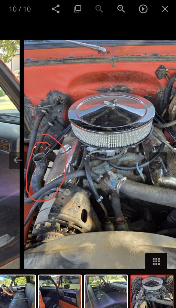

Good day,
I recently inquired a 1976 C/20, and noticed there is a tube attached to the bottom of the engine ( Upper stove?).
It goes to nothing so I’m curious..
Can I plug that tube, or take it out even?

No need to plug it,you might want to keep it,in case you decide you need it in cold weather. It is hurting absolutely nothing sitting there.That had a big hose that feeds warm air to the carbureator in cold weather. Even with an open element air cleaner like yours I've still been able to run warm air in the winter by making a wrap for the air cleaner that had a port for the warm air hose.

Welcome from Austria. You can remove it if you don't like it sitting there and live in a warm area.
I would put it on a shelf, many of these parts are no longer produced or sold anywhere.

A factory stock air cleaner has a place on the snout to connect that tube, and the connection has a vacuum and thermal controlled flapper.
When the engine is cold, the vacuum flapper opens up the connection to that tube and you get heated air into the carburetor. Engine runs better and there is lower risk of moisture in the air freezing in the carburetor. As the engine gets warmer the air heats the thermal control and it slowly closes the flapper, and now you get cold air into the carburetor. The snout of the air cleaner usually then had a plastic tube leading over to the radiator support and the cold air intake.
You can probably twist that tube a little to break it loose, and it will slide up and out of the manifold heat stove. Then set it aside for later, in case you want to use it.

To expand on what others have said no engine air/gas/vacuum goes through that. It leads to a housing on the exhaust which captures heat much like the heater on older VW Beetles. I kept mine on and hooked up simply because all the parts were there (though I doubt the vacuum assembly works anymore).
