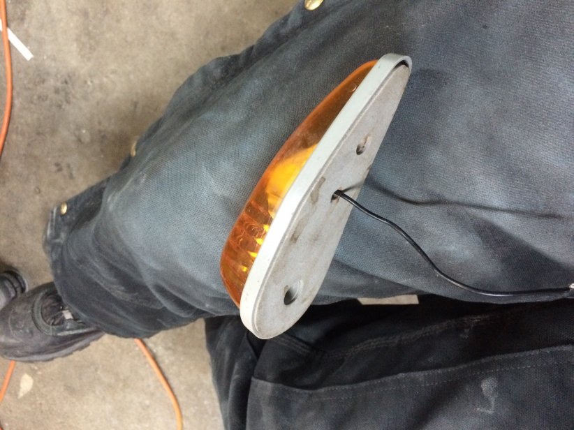

Bought some cab lights for my k-10 a while back never installed them have no directions they only have one black wire coming out of them is that the power wire? Do the ground themselves with the hardware I'm going to use? Should I run an inline fuse? Then just run them to either a fuse that's hot while the key is on or wen the headlights are turned on? Thanks in advance

I just installed cab lights on my '77. Not too difficult. Save a lot of time, go to Home Depot and buy a cheap wire fish for $12 to feed the wire from hole to hole. Your ground will come from the two mounting screws. Remove headliner if you have one and the A pillar trim and run the wire down there to your fuse box. Use a test light to find the accessory plug-in point that is hot when you turn on your lights. That is the place to plug in your wire. Good luck.

My guess is these aftermarket lights have a metal tab for a ground on one of the mounting screws. Make sure the gaskets are in good shape or you will have water getting inside your roof. I've seen other people use RTV to help seal them. I would hook them up to your parking lamp curcuit.
