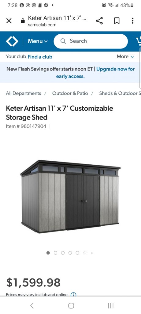

I don't know situation storage wise,neighborwise etc. I bought a trailer similar to that one with plans of building a simple shed on it to store stuff out of my way but on my property. I'm going to 4 sides and a sloped roof like this one. I can fill it and park it behind the barn.
