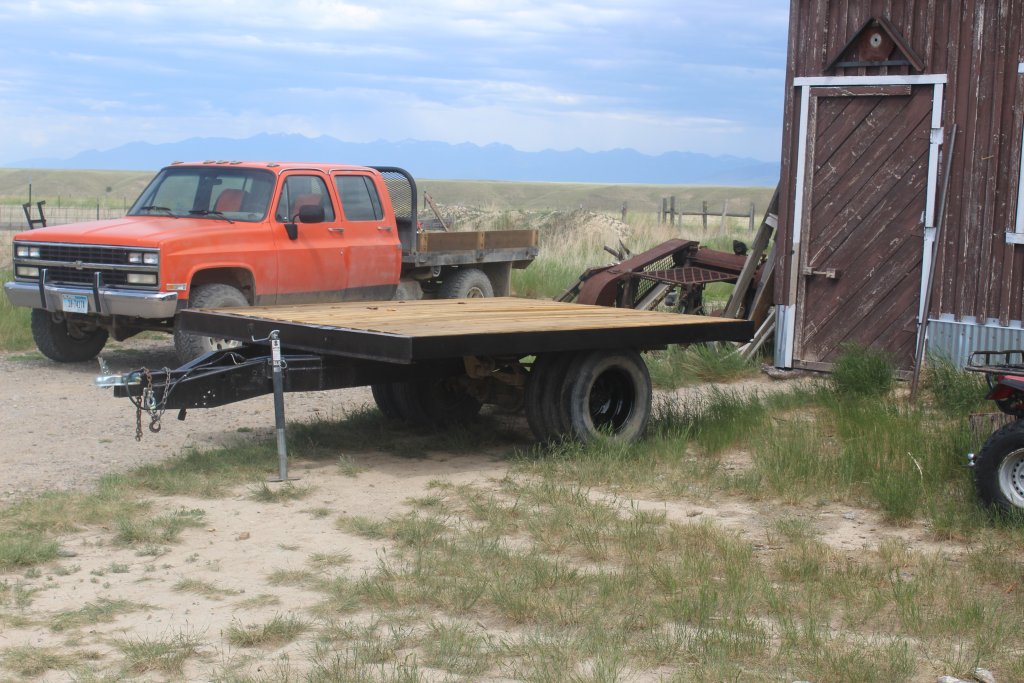

Trailer more or less finished. Came out 10' long and 8' wide, on the deck, plus about another 4' on the tongue. Seems to run down the road just fine. Am planning to build 4' stake sides for it, which should allow me to get close to 3 cords of firewood on it, if I mound it up some. My initial plan was to use square tubing and weld soem cattle panels to the frames, for the sides; that plan's gonna cost a bit over 300 bucks though, so I'm going to try and dream of a cheaper solution, that still won't weigh a ton, since I'm going to take the sides on and off a fair amount.
Aaron
very nice. If you were closer I'd saw you up some rough sawn white Oak from my sawmill. Just sawed up some butt Oak for a trailer floor.
Oak would be cool. I've got a friend with a sawmill, so I just used a bunch of 8/4 fir. I'm intending to hit it with old motor oil. That's what I did on my flat bed on my truck, and I think it will work well.
Try boiled Linseed oil. Old motor oil can break down the wood with time, although some guys have had good luck with old motor oil.
