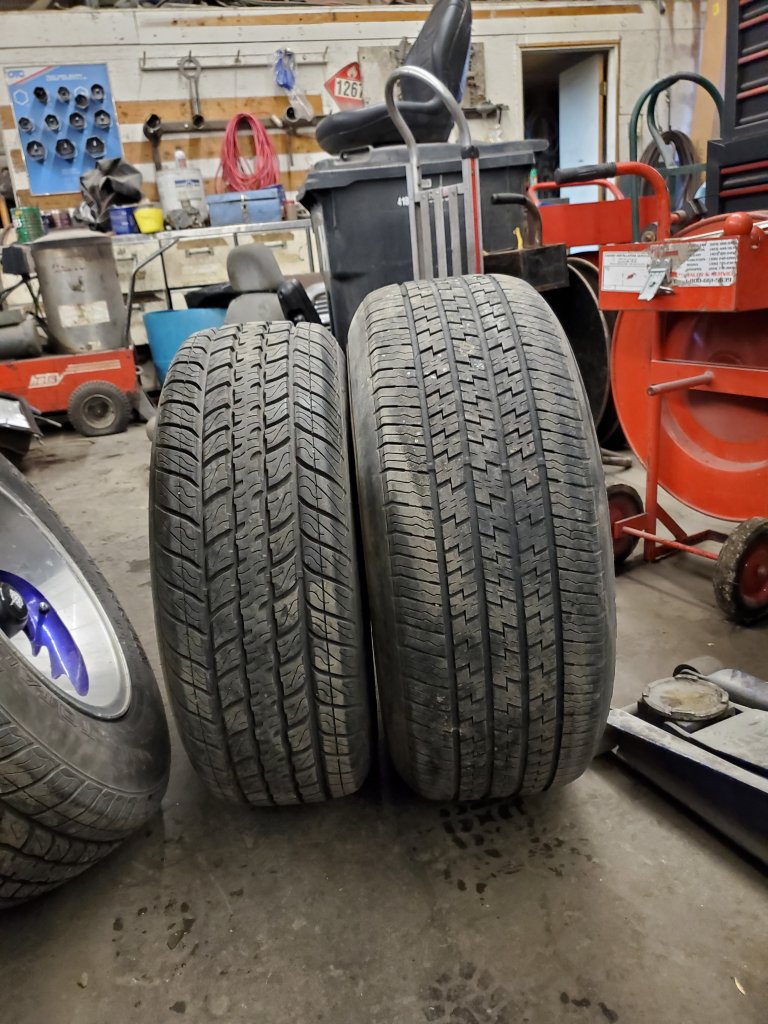

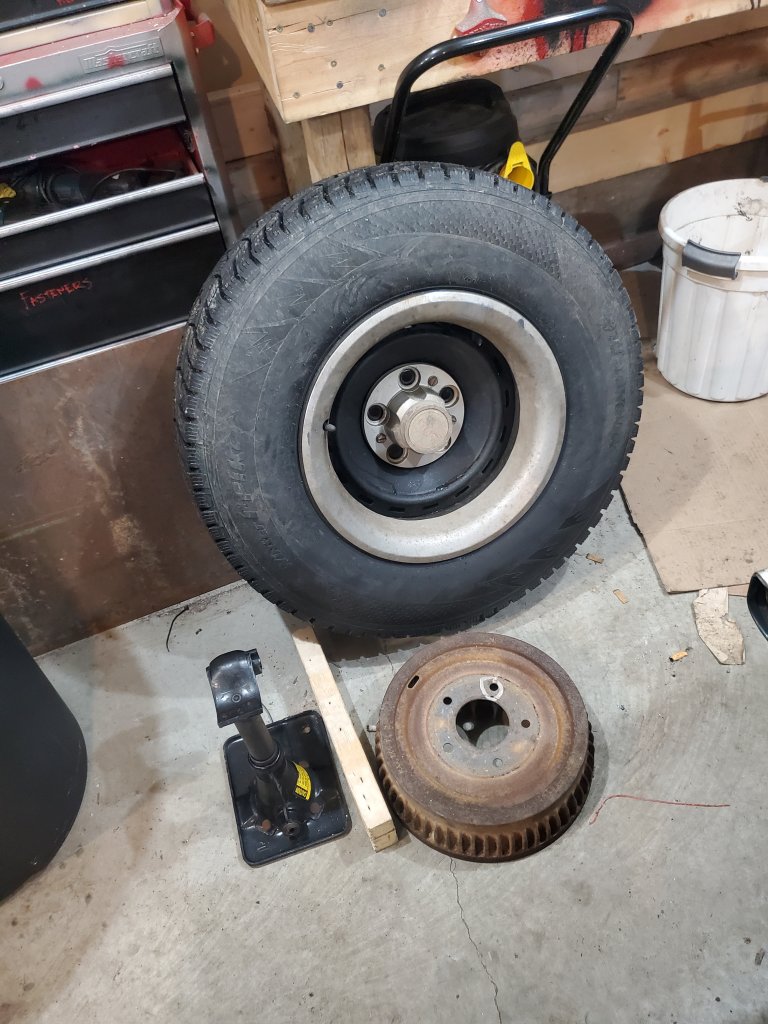

I recently replaced my 3.08 gearing to 3.42 on my 8.5" and since then my speedo is out to lunch when I'm trying to do highway speed (100km/h). Needle is buried when I'm only doing 109km/h.
How could I recalibrate this. Also have my winter tires on and the are 235/75r15. Also will have to adjust for my summer tires which are 235/70r15 rear and 225/55r15 front. Transmission is th350c.
