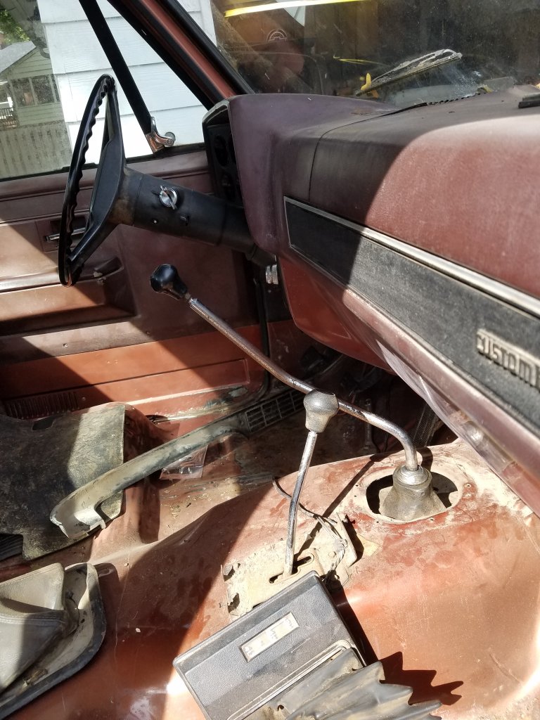

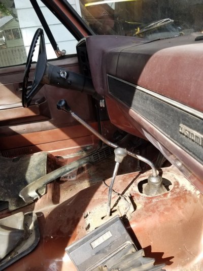

OK next question....so cab removal with on a 4sp 4wd. the 4wd shift lever will not be a problem but I think I will have to remove the trans gear shift to lift cab , whats the easiest way?

I am removing the cab to put on another frame. Just looking for an easy way to take gear shift off so I do not have to lift cab up and off of long gear shift
Push it down and twist, it will pull right out!

No way......see I woulda thought it was gonna be a pain......this forum has saved me so many times from doing things the hard way or taking things apart more than needed

So I have gently tried to push down and twist/rotate the gear shift and no luck. Could I be trying to do it too gently ? do you need to shove it down and give it a hard twist.....didnt want to go to hard first try

found this on youtube. I was pushing down on the gear shift. it is the outer ring that gets depressed and rotated.
