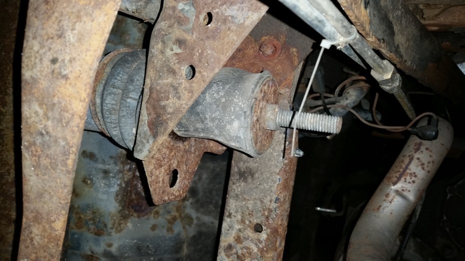

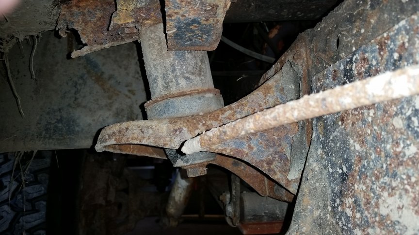

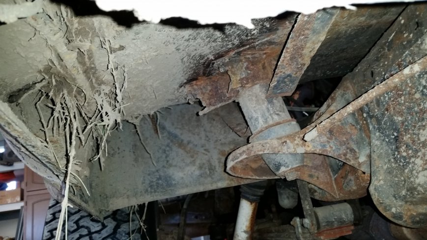

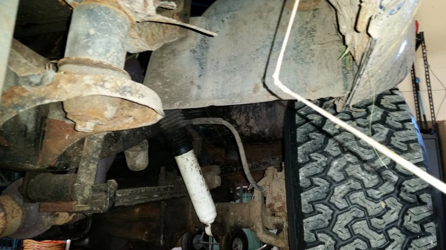

Here's some pictures if this helps at all. Sorry for the mud but she isn't a pavement princess ;)

Looks like you have a cab support issue.

Score one for Mr Obvoius! Anyway, what you want to do about it? Doesn't appear to be much to attach repair parts to..... I have successfully supported a cab temporarily by installing angle iron from the side of the frame up to just below where the fire wall meets the floor on both sides. Ran like that for about two years untill I found a better cab on the cheap.
You aren't far from me and within the next two years I will have two cabs available. Both are in better shape than yours and the one on Ol' butterscotch is all patched up already. And the one from Clifford is savable. Will make you a deal.......
