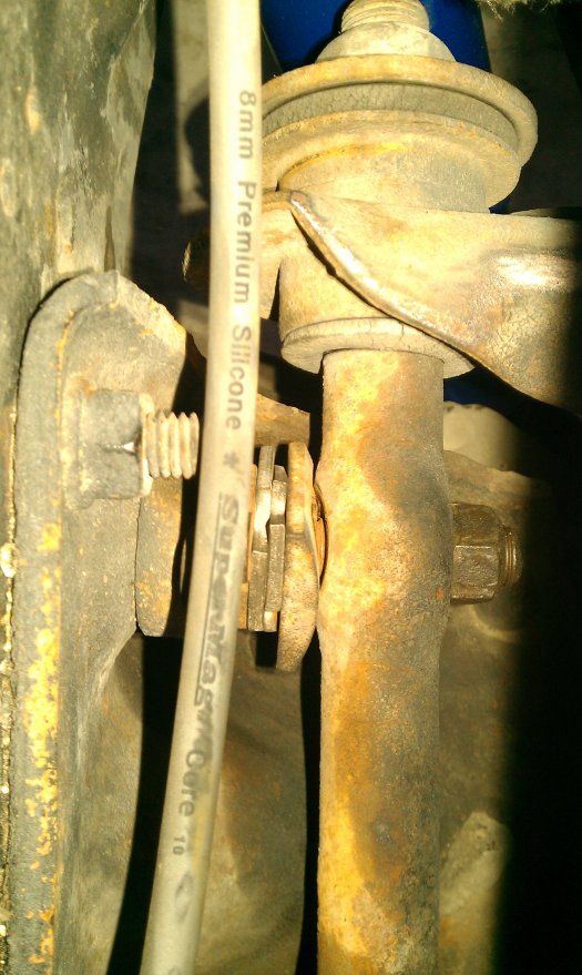

Not a good pic but it's the only one I have(truck is all apart now). I bought the truck already lowered, it had WC 3" springs, this was the stack up with pretty much 0 Camber and 4.5* Caster on this side and there was about 1/4" of bolt left sticking out on the forward bolt, I'm definitely not going this route when I put this back together..
BTW, if you use a thin cut-off wheel to cut a coil off, you will not heat up the spring at all..

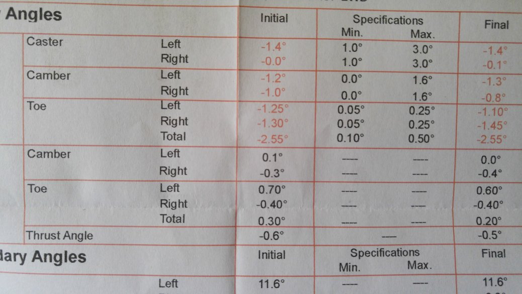

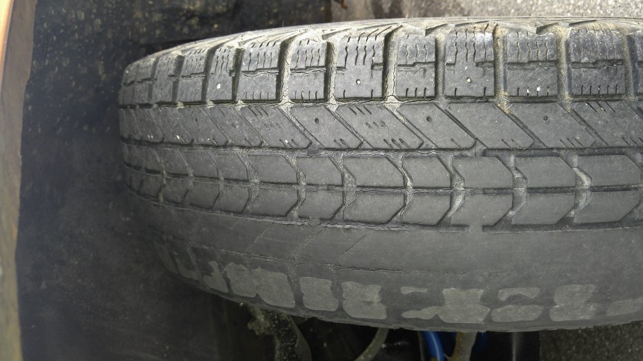

So my next question is.. the alignment sheet said the left side was in by a full 1*... I know I have some play in the balljoint mount bolts, plus I picked up a shim kit which is 1/32"... how do I figure (to get it roughly close) how many shims to add to get the degree of camber back in it? When I go to loosen the ball joint on that side on my next day off, I'll measure how much I got it to shift outward on the control arm, but it'd be interesting to know how much of a degree (or more?) of camber it gives me.
A couple images for your amusement... the tire was even tread less than two weeks ago (the tires were crap to begin with)
